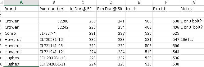

I recently spun a few bearings in my 440. I picked up most of a used 383 from a guy about a month ago and I'm now purchasing all the parts to put it together. The bottom end is all together, looks good, and turns over smoothly. I am about to purchase a cam to put in it and I was hoping to get some suggestions from you guys since this is my first car and I don't know everything about cams.
Here are the specs and the cams that I am considering right now.
Vehicle: 1989 D100 Will see maybe 1000 miles a year as it's mainly a toy
Block: 1968 383 bored 30 over
Pistons: Flat top @ zero deck NO valve relifs
Head Gaskets: Steel .020 crush
Heads:1968 250 casting code. Have 2.14/1.81 valves installed and are not shaved.Will be home ported
Intake: Torker 383 with gasket match porting
Carb: Holley 4160 750cfm Vacuum secondary
Gearing: 3.55 posi 9.25"
Stall: 3000 B&M Holeshot in a 727
Weight: About 3800 with me in it
I plan to rev it no higher than 6000
I need something that will give me good power, but not have too large a lift at 50 and cause a piston to strike a valve.
I'll attach the ones I am currently looking at.
Thank you for any suggestions.

It is really just a toy and a tire burner. It has long tube headers going into dual 2.5" pipes with flowmaster super 40's dumping in front of the pass rear tire. I am going to add a vacuum canister for the power breaks. The 440 had a 501 lift comp cam and didn't have any issues with the breaks. The previous owner of the 383 said he was running a 300 duration 528 lift cam without any clearance issues.
I was leaning towards that last hughes cam since it had good lift with a short duration so that the valves would be nearly shut before the piston made it up close to tdc.

I called Hughes earlier today and they suggested I run their part number SEH2832BL-10. This is one of the ones I was looking at anyhow so I will probably get that and take their advice and run a slightly thicker head gasket.
