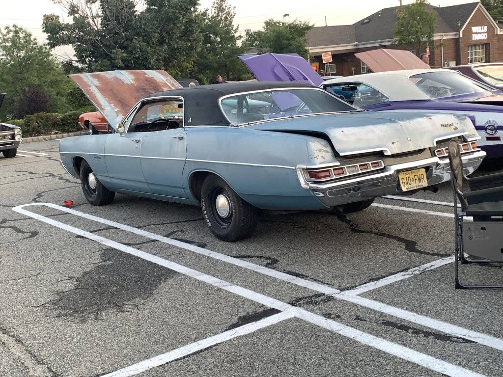

My car sits a bit too high in the back (at least for me :) )
It has these shocks with coil springs attached to them, would the ride height change if I put regular shocks in there instead?

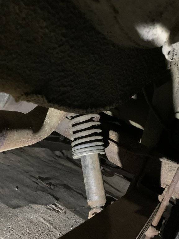

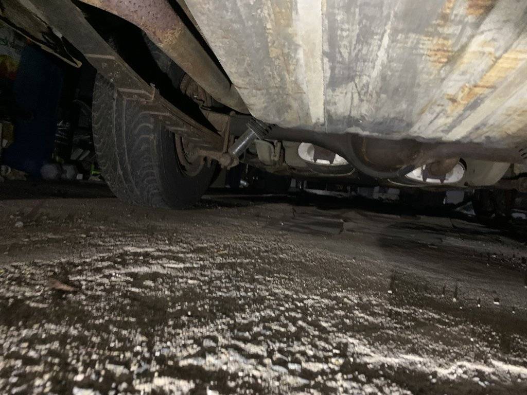

Here a pic, I know it's a bit hard to see
Those look like Monroe's. If they are.. you can jack up the car a bit and then get underneath. Push up and twist the bottom of the spring. It will take bottom plate off its keepers releasing the spring tension. You can then see if the ride height has lowered. You can remove the bottom nut and then remove the spring if you wish or simply reinstall it as it was. I doubt it will lower it but you can give it a shot.

Also does the rest of the spring area look factory stock, or does it look like something's been added ?
Once you jack it up a bit, the tension will come off rather quickly. No compressor needed.. Just a little strength.. same for going back on. Push and twist.
Can't answer second question. Maybe take better pics and one of the resident experts can chime in. What's the leaf count on both sides?

pretty cool, So once you do that it will just be a normal Monroe shock?
I would assume yes but I am not an expert. I only know the spring comes out as I had a ride height issue and was doing some troubleshooting. I don't think the height will change without the spring. Good luck
Those shocks were probably installed because the leaf springs are worn out or the previous owner got tired of the rear of the car scraping the ground all the time. Or, because he frequently carried extra weight in the car. Regardless, installing ordinary shocks will lower it.

Thx, should be an easy swap
As mentioned, the generic name (which was also the Monroe trade name) was "Load Leveler" shocks. If you look, the coils in the middle are closer together than at the ends. This results in not a lot of spring tension in the normal "ride range", but added stiffness when there is additional weight in the back.
When I got my '70 DH43N car, it had them on the back, as did my '67 Newport CE23. The '70 had been used to pull a travel trailer with, so the rear springs were tired, but the rear end of the car sat lower anyway. So, the answer to the question is "No, not designed to raise the rear ride height, just keep it more normal with a load."
