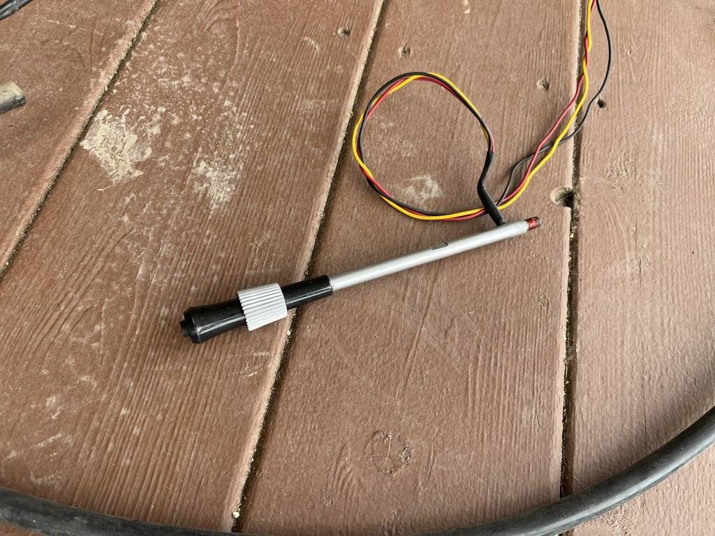

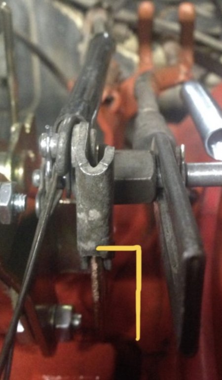

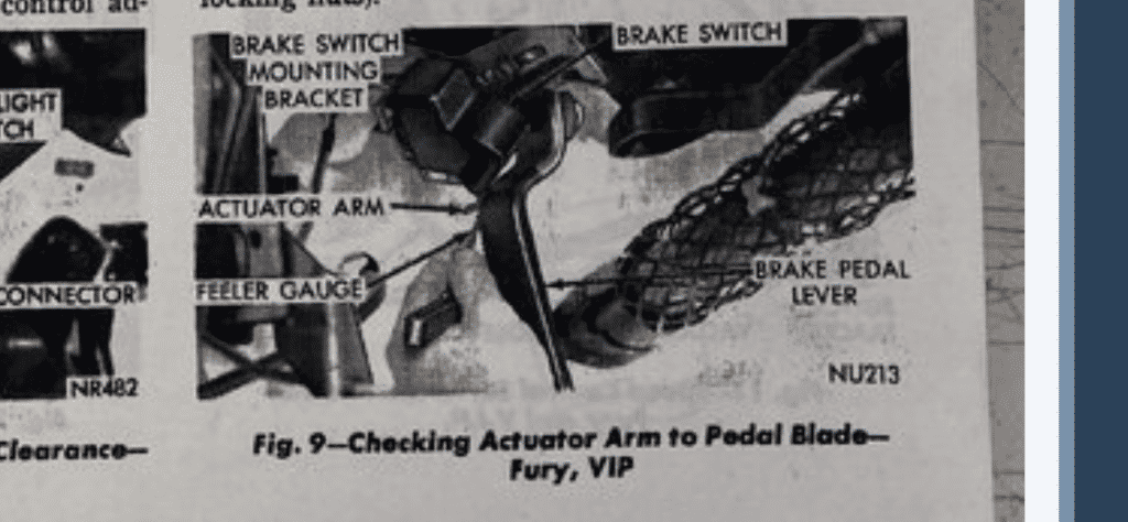

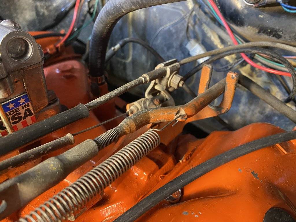

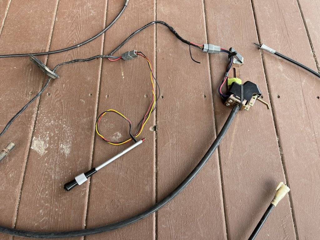

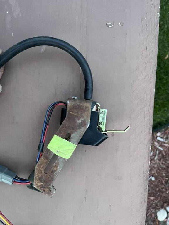

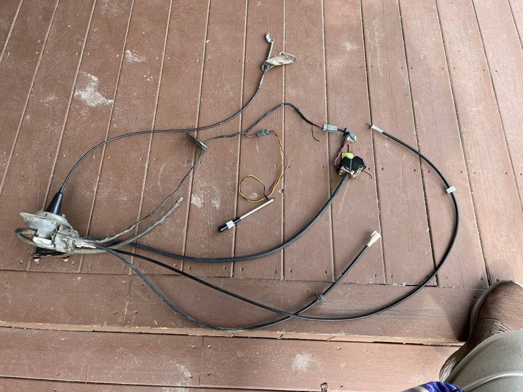

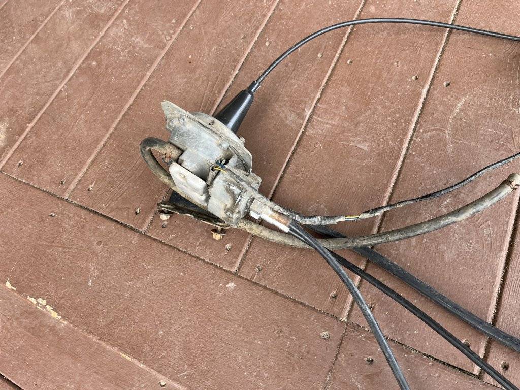

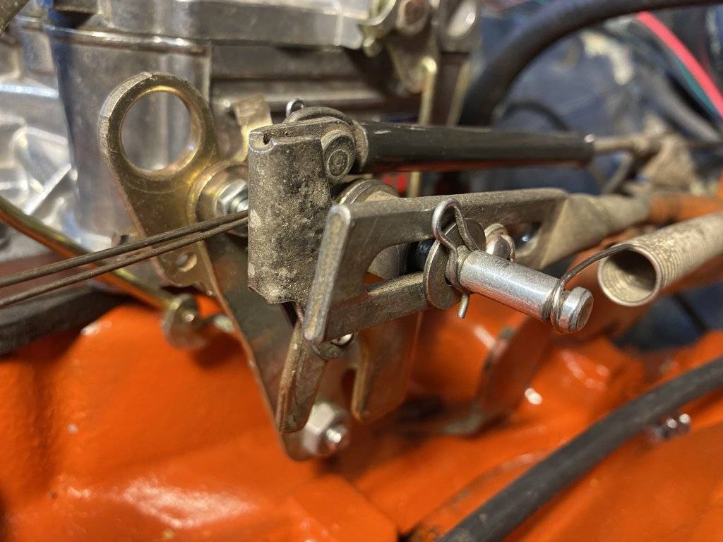

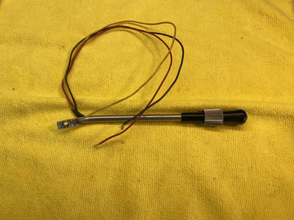

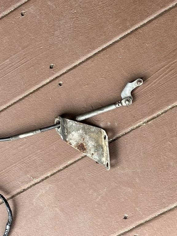

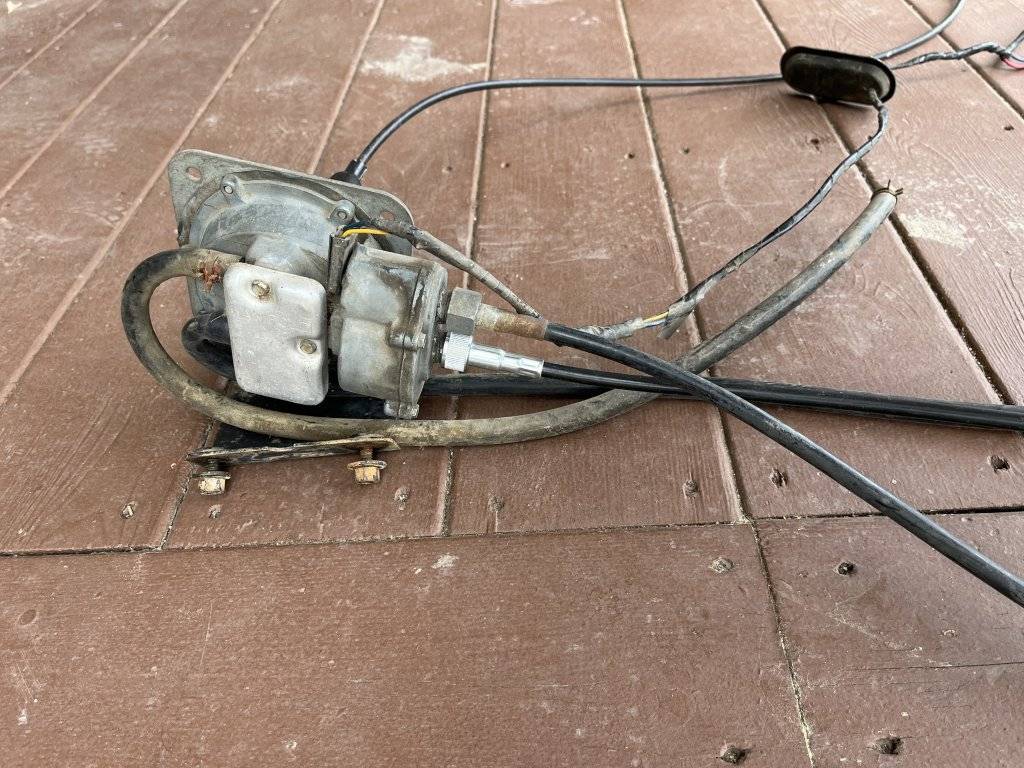

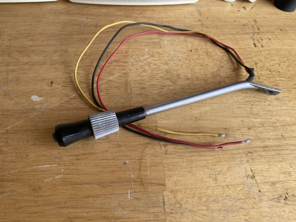

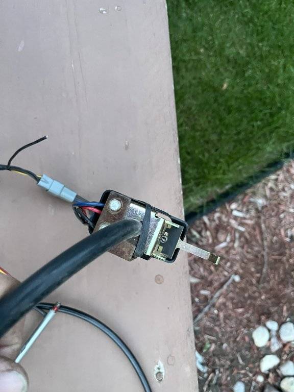

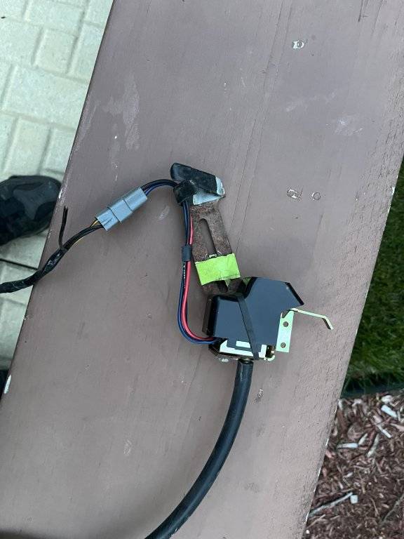

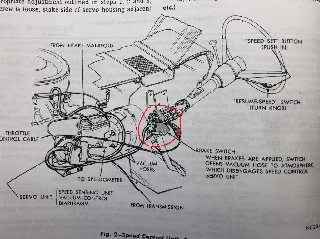

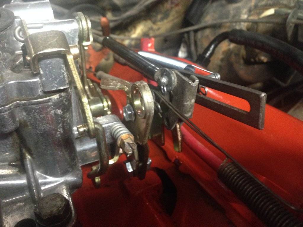

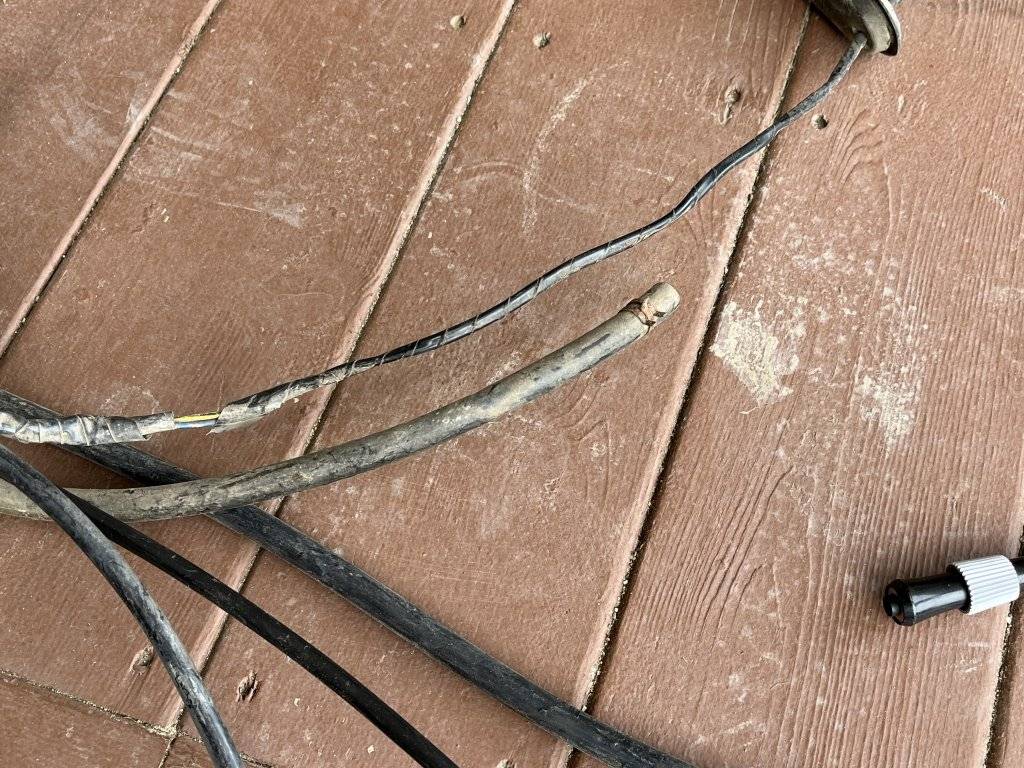

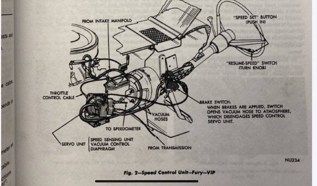

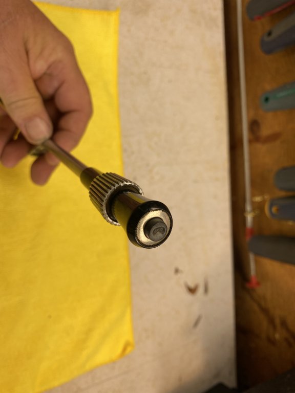

Here is a 1969 cruise control setup from a 1969 Imperial with tilt /Telescopic steering column. The 68/69 only cruise controls had 2 vacuum hoses coming off of the servo , one going to the vacuum/ electric solenoid brake switch . When the brake pedal is pressed the small arm onto the switch activates the solenoid open and disengages the Cruise Control . When the Cruise Control is activated on the solenoid, closes the vacuum switch and energize the system . The vacuum switch operates the Cruise Control only, it does not have anything to do with the brake lights , that is a separate system altogether . The other vacuum line goes to the brake booster for vacuum to the system. The signal light stock for the tilt steering is a screw in stock. Not tilt steering columns the signal light stock is held in with a screw. Is it worth installing? Absolutely. It’s a bit of a pain in the butt to get underneath the dash to install the brake switch as well as running the wiring through the steering column but I wouldn’t be without it on my car. 1970 and newer Cruise Control will work just fine in your car, but it will not be original . Their brake switch is not a vacuum set up , it is an electrical switch . It will install and work just the same.

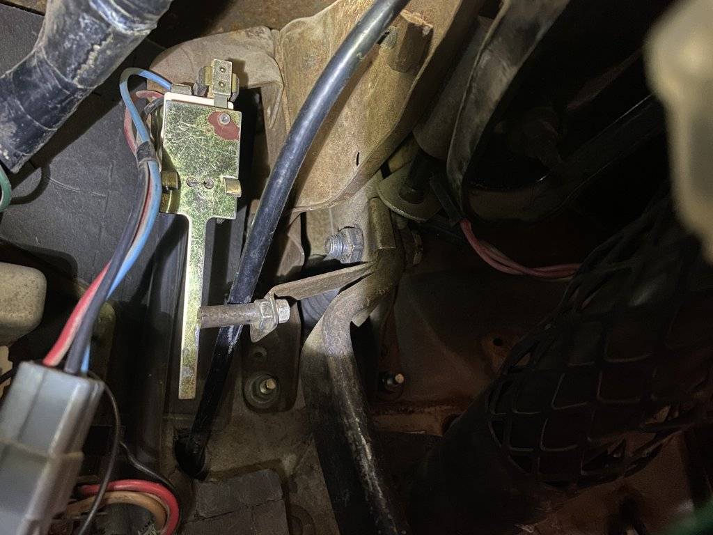

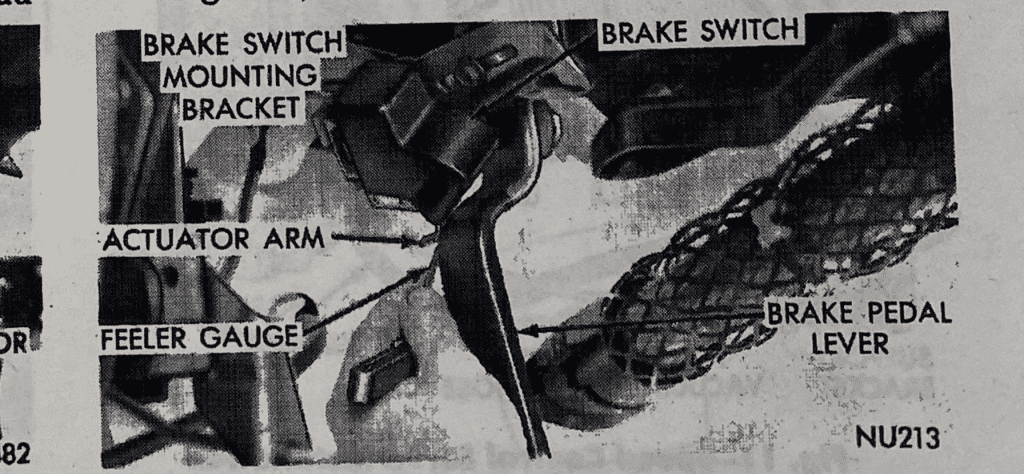

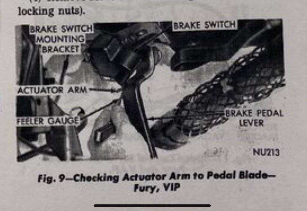

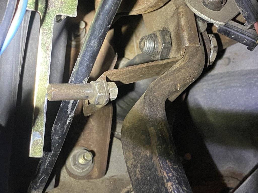

Here are a couple pictures of the brake switch under the steering column in my 69 Sport fury . It is best to take your front seat out to get access under the dash and a few of the Cruise Control carb linkage.
The 1968/69 Cruise control was a two year only system . That being said a cruise control system out of let’s say a 1977. New Yorker would work just fine in your car as long as you have the complete system. They used the same servo right into the mid 1980s. Be sure to get the proper signal light stock if you are looking into a later model Cruise Control. The brake switches can be adapted to the car . Good luck with your project. You can PM me anytime if you have questions. I probably have two or three (different year) Cruise Control setups ups on the garage shelf for reference .
I've put the system in a couple of post '70 cars and the difference I see is the brake switch. Electric in '70 up rather than vacuum. They changed the column switch to a different style around 1973, but I believe they will interchange.
So, I think a later one with the electric brake switch that's combined with the brake light switch would be probably be easier to install, but the switch is harder to find.

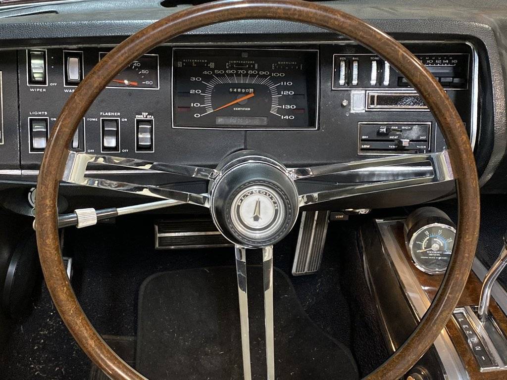

And I really like that "recall" steering wheel.
