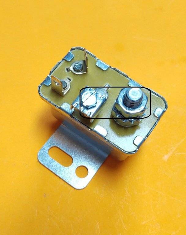

Does anyone see my mistake in photo #1?
If you don't, what happened was I had taken off the tin bendix cover to lube the slides for the fork and add some white litho grease to the reduction gear. When I popped the cover off I didn't notice the position of the tab (doh!), so when I put it back together, I put the tab INTO the recess, instead of resting it ON TOP OF the recess. This caused the bendix to not return all the way, hang on the flywheel, and scrape away!
I realized my mistake as soon as I looked at the "new" unit in the box. I'm gonna keep the extra starter around just in case something else lets go, I won't have to go shopping first.
