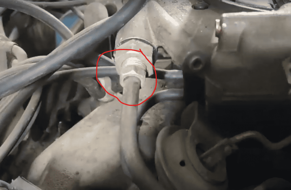

Hello,
was trying to pull TQ from my BB, but this nut seem to be super tight. I wonder if there are any pitfalls? Reverse thread maybe? It's getting round rapidly but still not moving. Left it soaking in atf for now..
It's a right hand thread.

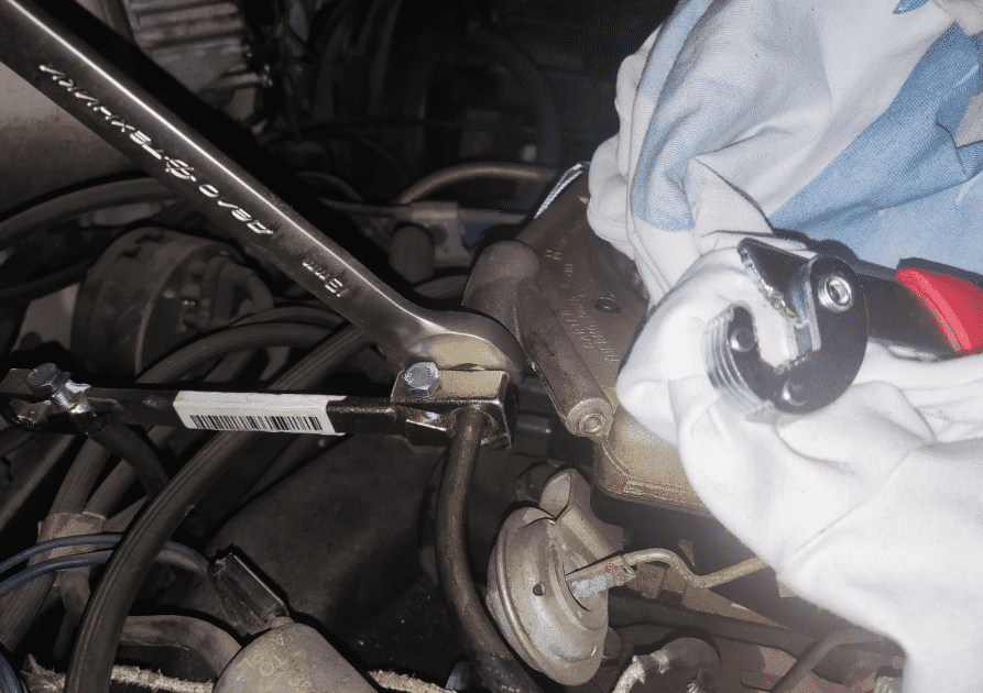

Put the proper wrench on the fitting in the carb (7/8"?) and a flare nut wrench on the tube and it will loosen.
I have set of these flare nut wrenches, but this wrench still was stripping the nut.
I've also tried universal wrench, but it was either el-cheapo one, or nut is too small for proper grip - it was spinning too.

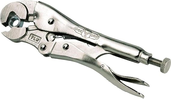

Vice grips and pipe wrench was the last method, since it's easy to destroy nut completely, so I used this one and finally was able to release it with light tapping.

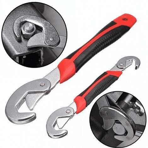

I assume its main purpose is to crack loose different bleeders, but if "spread a bit wider" it is possible to squeeze a line inside of the wrench and use it in such situations.

That said, once you start rounding off the nut, the vise grips become your tool of choice.

Thank you mate, problem solved already with this wrench
