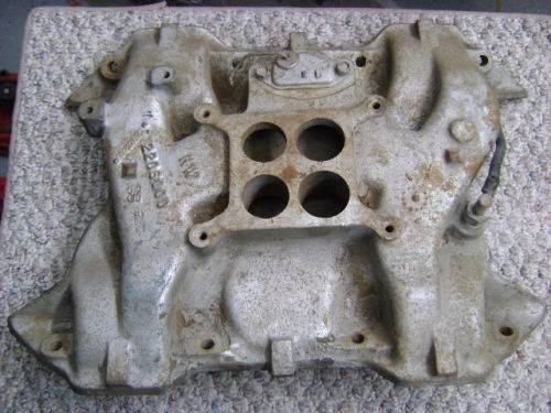

I don't know what your 383 intake is like, but on my 65 413 intake, the butterflies would not fully open. The bores on the intake were a little too small. I used the intake from a 67 440 to solve the issue. I used the Edelbrock 1411 carb, BTW.
My intake
My intake
That's what I was thinking. I have a 68 4 barrel intake that might do the trick
