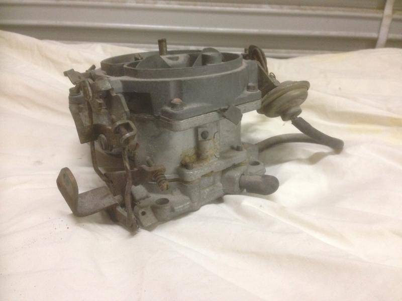

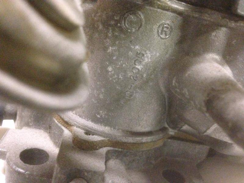

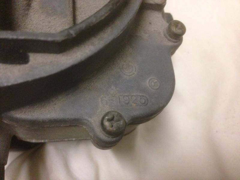

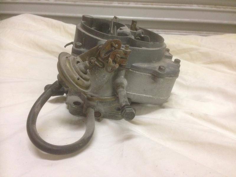

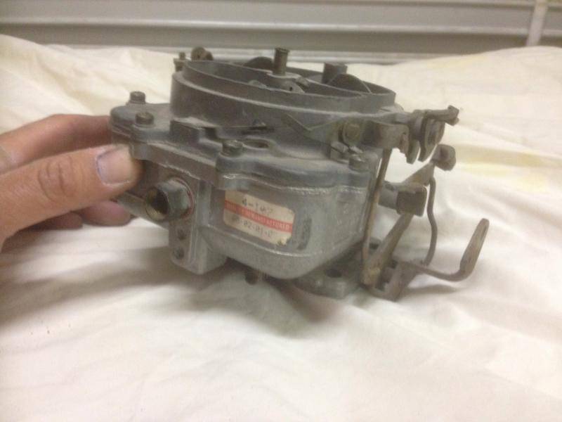

I have both. The Holley came off a 360 & the Carter a 400. They ran when removed, but that's been some time ago. I will get you a pic when I get back. If you do end up rebuilding a carb use a good quality kit. The parts store kits are not too good. Carter, Holley or OEM Chrysler. Worth the extra coin

Carter carb
It has a rebuilders decal on it. Linkage works good. Other than shelf dust looks to be pretty clean
Hopefully these come through good
Pictures came through good and thank you. I am going to get another carb from this company first to see if that works. They are trying to make it right. I was against it at first but they really seem to want to do the right thing. If this one does not work I will get in touch with you. I appreciate your help and all the help I have gotten from this website. It has helped me tremendously
No problem. If they will make it right that's the smart thing to do. Let me know if I can help down the road on anything else.
