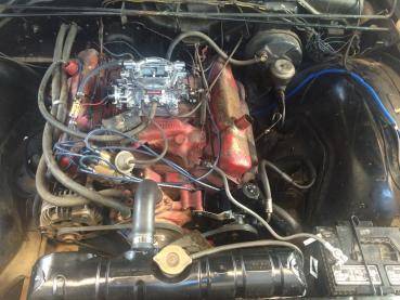

image.jpgMy 66 300 showed up with a transplanted '71 440 and a very badly set up Thermoquad with monkeyed linkage not the 383 and Carter 4131s I was expecting. Immediately went down to the local speed shop and picked up the Eddy 1406 with the chrysler linkage kit. They supplied a Mr Gasket spreadbore to squarebore adapter bolted on the Eddy hooked up linkage adjusted throttle cable and Voila the 440 came alive. Biggest hurdle was finding a steady 12v supply to run the electric choke. Tapped off of the temperature sender for now but proper fix coming. Really happy with how easy the Eddy was to tune. Next step is the Eddy intake but up here thats a 6 week wait. As this car has the transplanted 440 and non original seats don't feel too bad about the mods. My other 300 is stock and purrs with the Carter

A 440 with a single circuit master cylinder? I'd switch over to a dual circuit master B4 the Eddy intake IMHO - SAFETY FIRST!!!
Might explain why it had absolutely no brakes when we picked it up lol. Disc conversion on the todo list.
