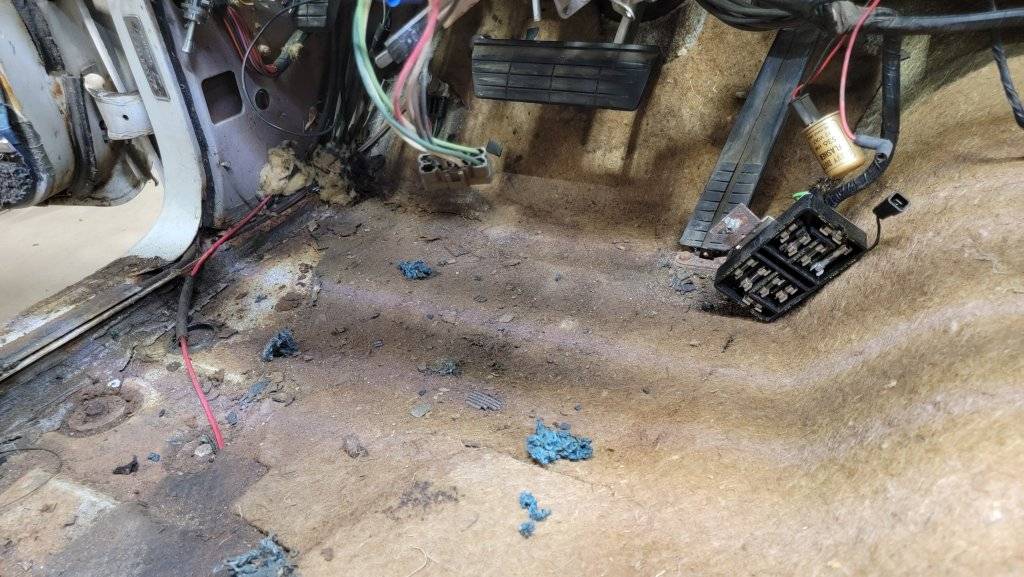

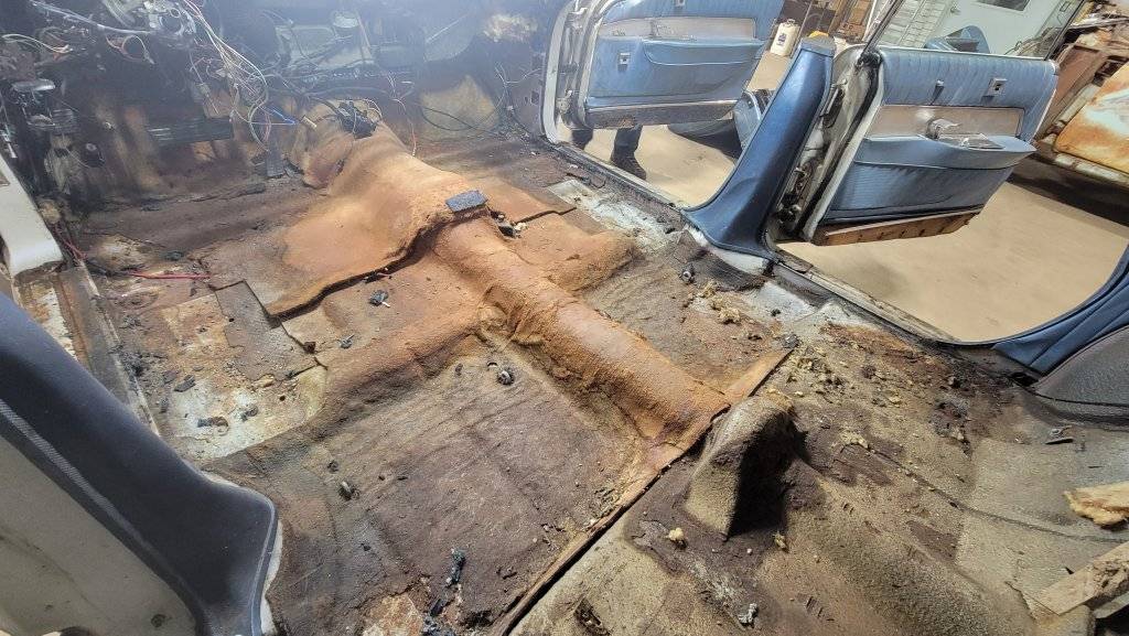

Does anyone know where to get this correct carpet padding for a 1962 Crown?
Your local home carpet store should have a variety of different carpet padding, one of them should be close.
Alan
Normal jute padding was used back then. Probably 1" thick? Jute can become quite dusty, so be advised.
Your padding looks like it has the tar/rubber backing on the jute finer mat. You could use Fat mat or Dana mat type sound deadening and then the dry jute padding on top of that to retain the quiet comfortable interior.
In our then-new '69 Chevy pickup truck, under the bare carpet were some patches of a tar-like sticky material covered with a thin layer of white plastic fluffy material, two separate items, but worked together. The white item similar to what is between a brake backing plate and the rear axle housing for sound isolation functions. That GM stuff is in repro at some of the GM pickup truck repro vendors. The DynaMat-type stuff will work better, I suspect. Plus available from lots of places.
