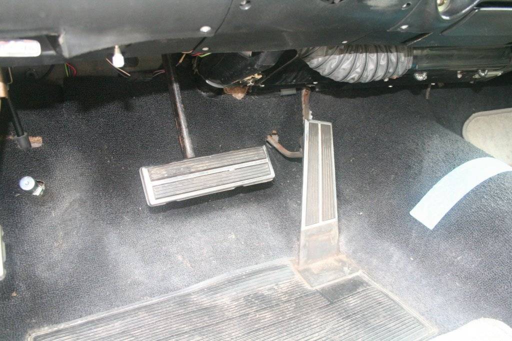

Any one have a picture of original installation? My Newport did not have a carpet when I purchased it, and I'm wondering about the gas pedal linkage plate area. Does the carpet get tucked under the gas pedal linkage plate or under the steering column plate? Any pictures or description would help greatly. Thanks.
hopefully this helps...
Thanks. but what I need is a picture of the fire wall area, where the steering column and the gas pedal linkage plate mount to the fire wall. I ordered sound deadener and padding, and still have to install it, but what I'd like to know is how this area gets trimmed out.
The carpet goes on top of both the column cover and gas pedal bracket.
You have to cut a hole or slit for the pedal arm.
I can get pics tonorrow if need be
John
OK thanks guy's. No need to post any more pictures. I will use the kings picture as my reference. :thumbsup: Didn't want to start cutting until I was sure. Appreciate the help.
