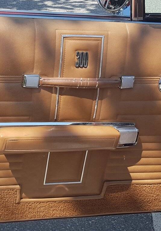

Is the carpet on the door panel bottoms glued to the panel?
the carpet is the same saddle tan as the rest of the interior and is not specced on the tag.
here's my door panel with its original carpet ( pull strap has since been redone )
Sown on, not glued. They sew right through the board and everything.
