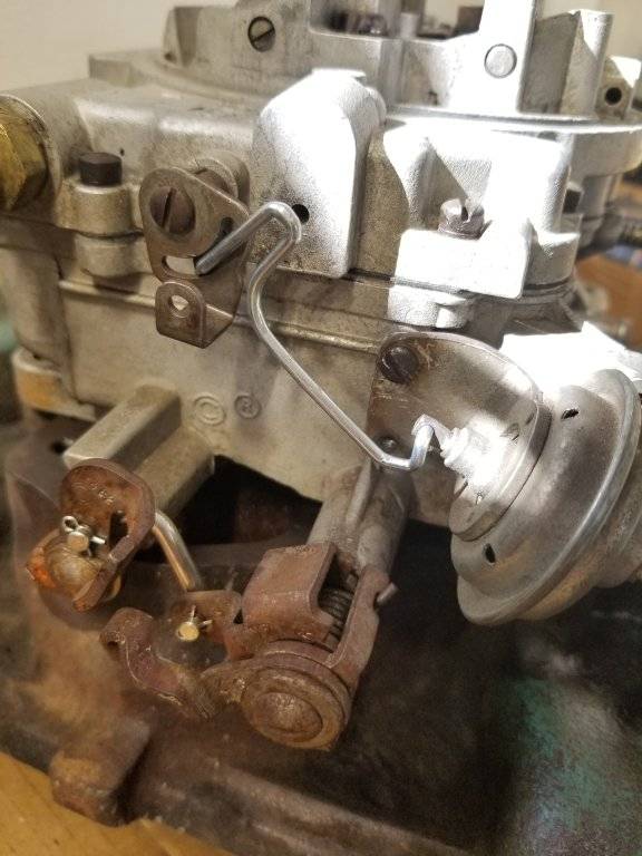

Hello again gents hoping you can shower me with your knowledge once more.
have quite a conundrum while rebuilding a Carter AVS #4635S.

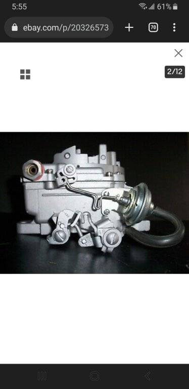

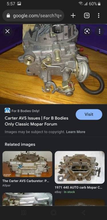

I'm at the point where I can plop the carb & manifold on to the motor but realized there's a linkage I'm missing that goes on the choke pull off.
I'll provide pics of the linkage i'm looking for from other people's carbs as a referance.

It would be best to seek to find one off of a carb core (that is otherwise "not rebuildable"), BUT being that it is basically a long rod bent-up, it should be duplicatable. ONLY thing is that it seems like there is a specific tang on the choke pull-off side which must be indexed to go into the hole on the pull-off and keep it engaged? But that might be replaced by a short right-angle turn of the new rod instead. From there, just match the length and angles of the rod. That "U" section is where any adjustments take place. Widen it slightly to lengthen the rod, narrow it to shorten the rod to get the correct amount of pull-off of the choke plate on a cold engine. But finding one from a carb could work best, in that place, too.

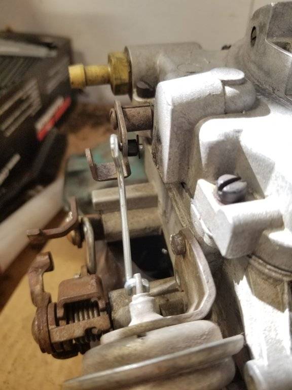

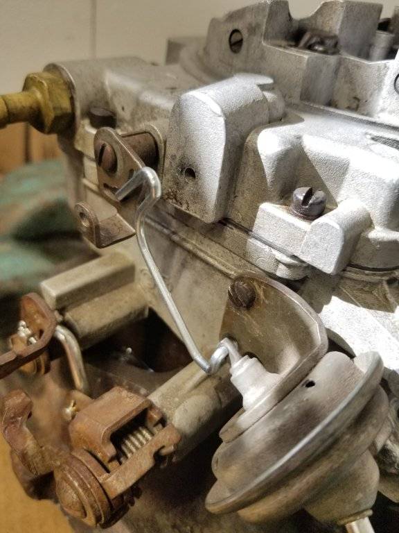

Thought I should update this thread after a short hiatus.
Ended up scrounging through my old stash of Carter AFB parts, found a pull off linkage I may be able to make work.
I'll consider other avenues if the linkage does not work once the AVS and the manifold is on the motor.
I believe the linkage was bought from Mike's carb parts a few years back.
