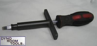

This tool is used to adjust the secondary air door on the Thermoquad. I think it was also made by Miller Tool
View attachment 126966 This tool is used to adjust the secondary air door on the Thermoquad. I think it was also made by Miller Tool
I don't have an extra original Carter tool, but to complete that tool in the photo you show, a long flatblade screwdriver inserts through the middle of the piece shown in your photo, so that you can hold the air valve spring from unwinding when you loosen the lock ring with that tool shown. It is kind of a neat tool and was used in the carburetor lab at Chrysler all the time when calibrating the air doors on the TQs. It really would not be hard to make one.
Or you could pony up $70 for this reproduction, and improved design:
Thermoquad Air Door Adjusting Tool

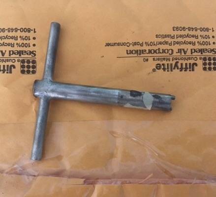

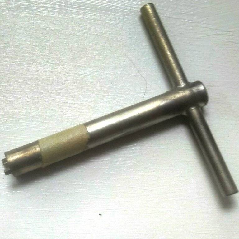

Lemme check my Asst TQ Junk box on the very top shelf pushed way back in the corner with other junk on top of it. But not this minute..
Edit
I think I made mine.
I'll know in the morning.
