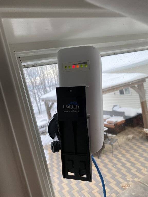

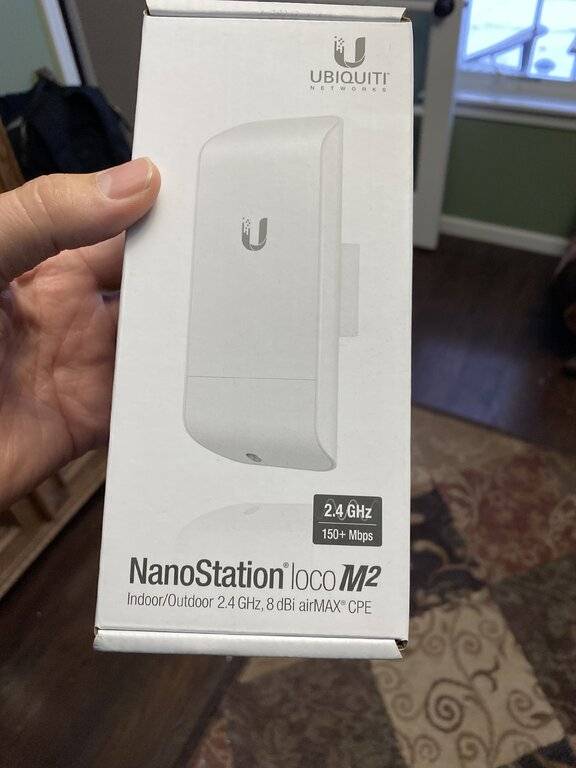

I also extended internet to my garage using this system from Ubiquity. It basically creates a specific wi-fi path for each direction and acts like running a hard wire. They can mount outside and transmit line of sight over 1/4 mile. Maybe more. Then I added another WiFi router in my garage as a bridge with the same network name. Both cell phone and internet work out there.
I can even stream Netflix out there.
You do need a pair of them.
They even have faster ones now.
Even though I could mount them outside, I just used a suction cup mount and put them on the window.
