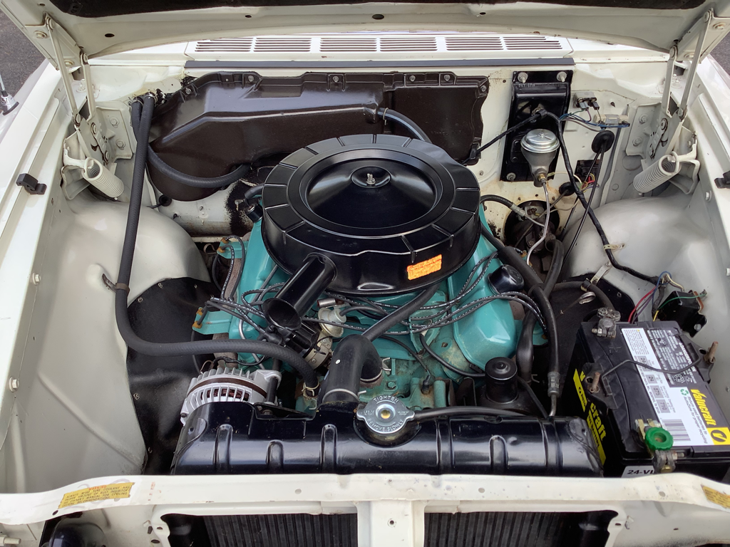

Car has been well stored, is not rusty, wires are in good shape. View attachment 745954

Nice sanitary view under the hood. The Ammeter in this car is calibrated to read only the current flow in to the battery (charging) or the amount flowing from the battery (alternator not operating or not operating properly). Most auto supply stores will give your system a quick check. You can use an analog (not a digital) to check Voltage at the battery when the engine is running. With everything operating properly, the Voltage at the battery should be 14 Volts +/- 0.5 V. Could be a weak battery or a malfunctioning Voltage regulator. I see a lot of other comments. Probably not the Ammeter. It's just trying to tell you of some other problem or problems. Best wishes. Let us know what you find.
