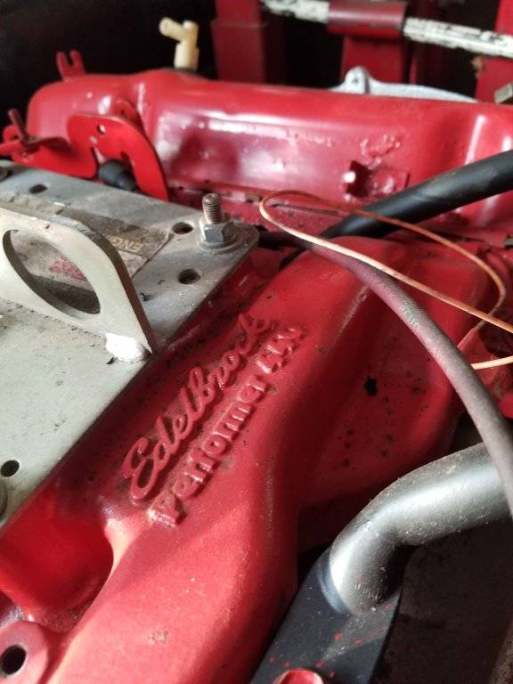

I'm using an edlebrock performer manifold on my 440. What choke thermostat works with this manifold while using a carter avs?
That would be the '73-'74+ style of Chrysler OEM automatic choke thermostat. Some come with a universal-length choke rod you can bend or cut to fit. They will be configured for a TQ, though.
Might check the Edelbrock website Installation Instructions for the intake manifold to see what they might recommend.
OEM or aftermarket AVS? Just curious.
