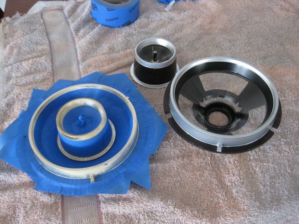

I'm doing the gauge surrounds for 65 polara. pic shows one side done, the other is masked and ready to spray using "Rust o leum 2X metallic aluminium" this is primer and top coat. initially thought overdone but cure to nice finish.
