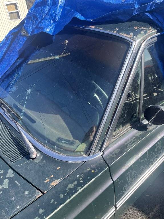

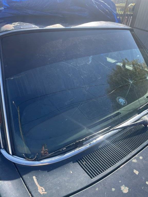

How do I get the windshield chrome off without breaking it or bending it

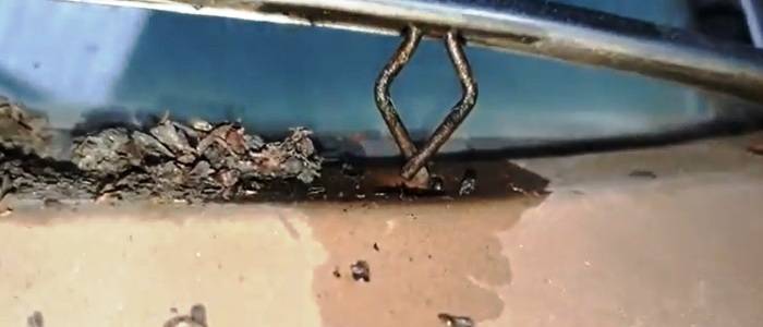

To take off the bottom piece: **There is a screw-in retainer at each end of the bottom trim** - up underneath the fender/A-pillar - you get to them with the door(s) opened. Once those retainers are out, carefully pry the trim retaining clips up and out of their holes.

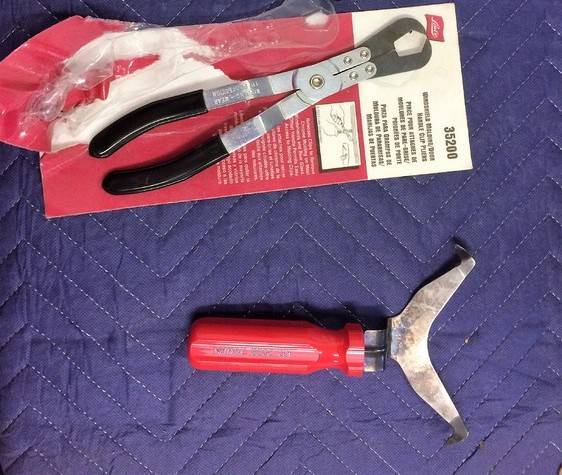

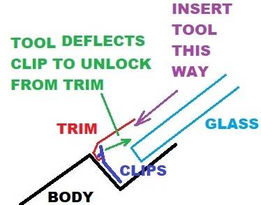

Once bottom trim is removed, work your way up A-pillar trim, and then across roof line trim. I use the top tool in this image. Bottom tool does pretty much the same thing, I believe. These tools release the clips one at a time by "retracting" them out of the trim's "lip".
