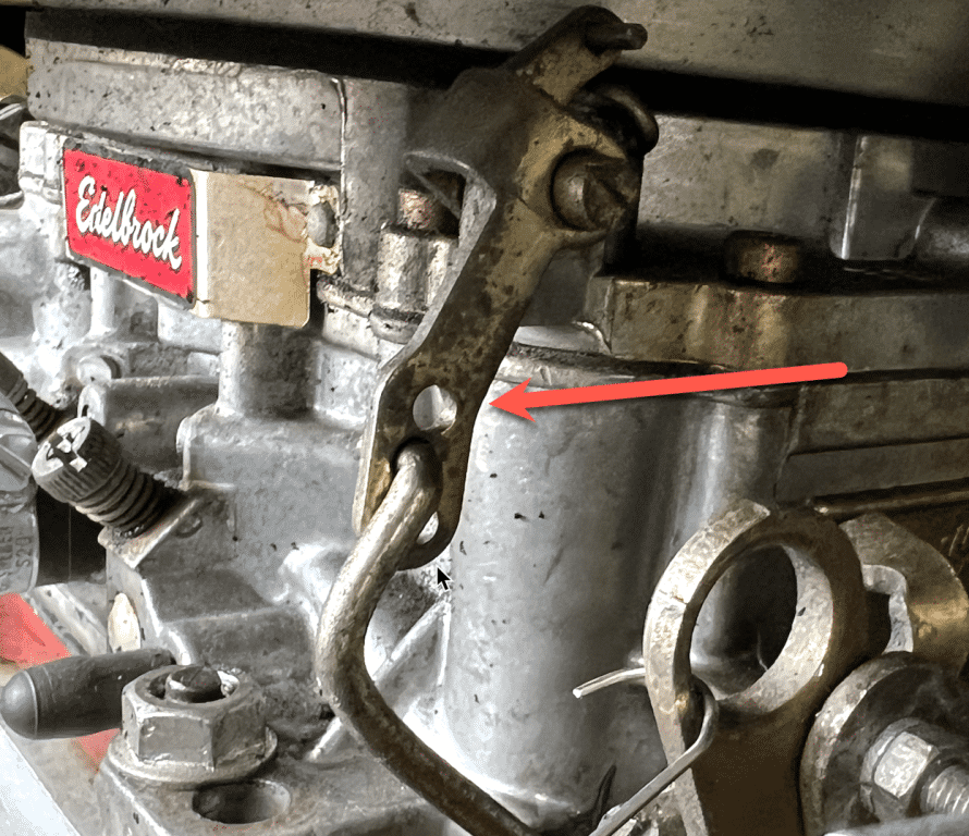

Currently, I believe that I may have introduced some contamination into the carburetor when I replaced a piece of the fuel hose.
An old Mopar mechanic told me to hang the part one level higher and see what happens. Now it is in the first position.
I did it... it's better now (I think so anyway) but it's still not gone.
