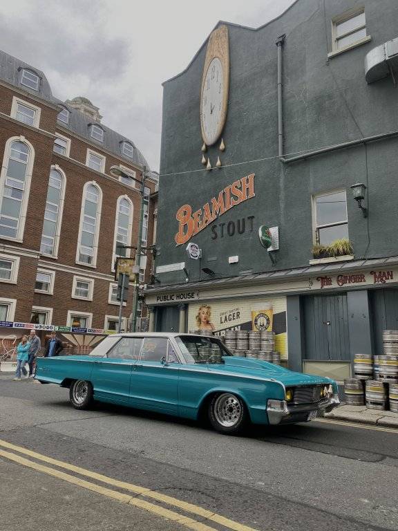

Hi everybody I’m from Dublin Ireland I’ve a 1965 Chrysler Newport 383.
I’m having an issue with my brakes.
It’s got power brake stock drums all round.
I went about doing some maintenance on the brakes due to have brake fade a few months back.
I ended replacing 2 front wheel cylinders due to the bleeder screws being rounded and I also replaced the master cylinder and brake line from the master to the proportioning valve.
The master cylinder I got was a (Centric) from rock auto it had a red sticker in the box stating “Do not Bench bleed”.
I have so far adjusted all 4 wheel drums till there is contact and I can feel the shoes dragging.
I have bled the brakes multiple times from the Right hand rear to the front left which results in a good pedal with the car off! And once the car starts and it’s in neutral or park it’s still fine but once it’s in drive the pedal goes soft and just before the floor il have a resistance!
There is no rod adjustment on the master with a nut like some master cylinders.
If I do pump it 3 times while
I’m driving I will get a hard pedal back!
So I’m left with 2 options that I can think of that I still some how have air in the system or the new master cylinder is bad? Or I am in fact supposed to bench bleed the master even though it says not too!
I hope someone can help me!! Very stuck!
Hopefully I’m overlooking something stupid!
Thanks very much guys!!
