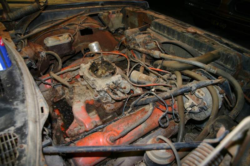

So wanting to clean out the engine bay but am unsure of what is safe to use and what to not get wet, etc. the car is not road ready, meaning I just recently picked up the car after it sat for 10 years. I turned it on a couple of times over the last week or so. I still have to adjust the carb to get it running well. Anyway here's what it looks like. A lot of pieces have surface rust besides dirt.
What products do you recommend to safely clean the engine. I thougth about spraying everything with a degreaser, letting it soak and then wash off with the water hose.
Thoughts?

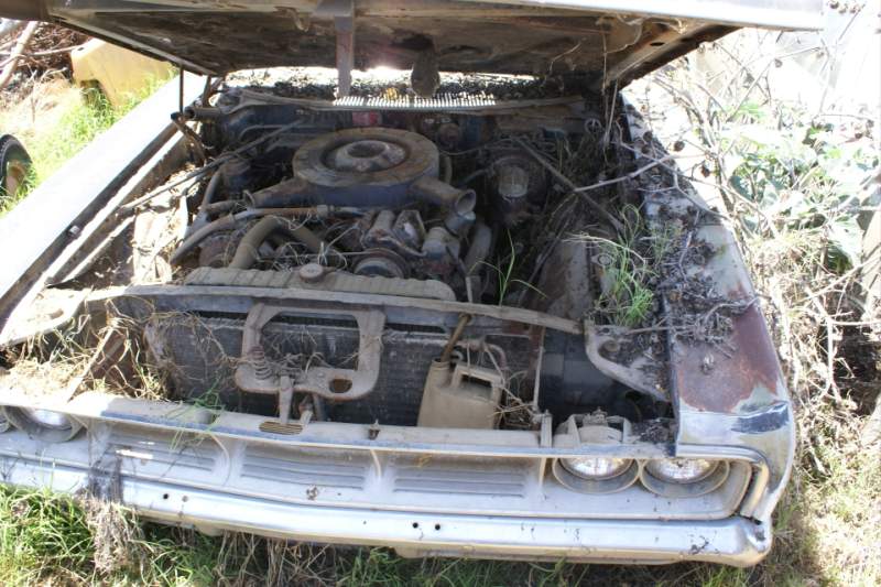

Before...
It is amazing how little it takes to clean an engine, my other Polara engine looked more black than red and with just a spray down it looked red and no scrubbing needed.
