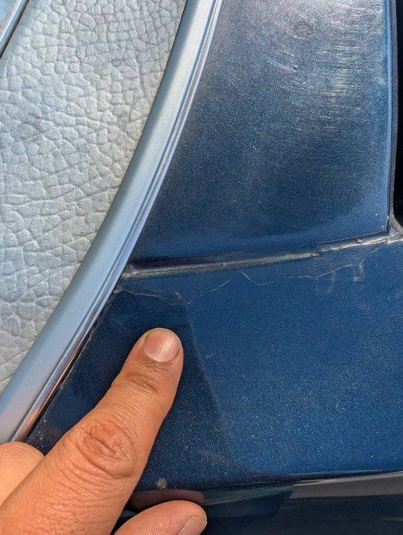

my car has been repainted and a tiny part of the clear coat is starting to peel. It's only from here so far and the paint job is a quality pain job. . What would be the best way to stop this? I was thinking touch up clear coat brush? Or do I sand a little first? Any input or advice would really be appreciated.
I forgot to mention that the clear coat stops at the line and has been peeling back. The previous owners had it with clear coat on just the sides or something and the clear coat would stop at the line on both sides. So it's only peeled back maybe, I don't know a half an inch at most? And this was done 20 years ago. The other side stops at the line perfectly. Not sure why they didn't clear coat the trunk and hood.
One the delamination has started, only way to stop it is to sand and re-spray. Or colorsand and finesse polish to get rid of the edge that is peeling. Might try some touchup paint clearcoat first, though.
Would need to get rid of the edge, though.
