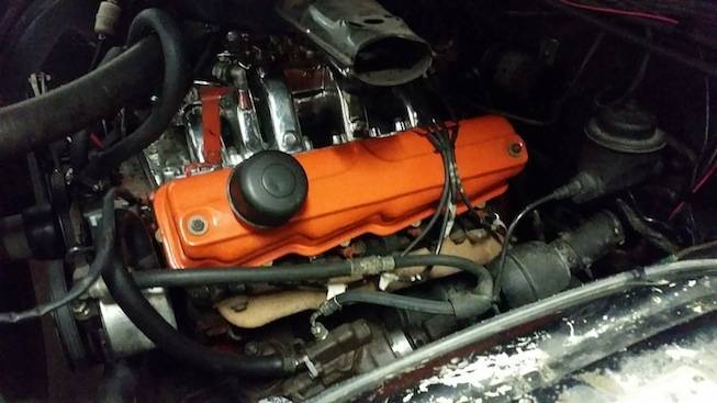

Can anyone give me some advice about what type of clutch, pressure plate I need for my 318 3 speed Fury wagon.
The car is in South Africa, I live in the UK and it is my next task to replace the above. I would like to source the parts before I go out to SA again.
The car is all original drive train.
Thanks
