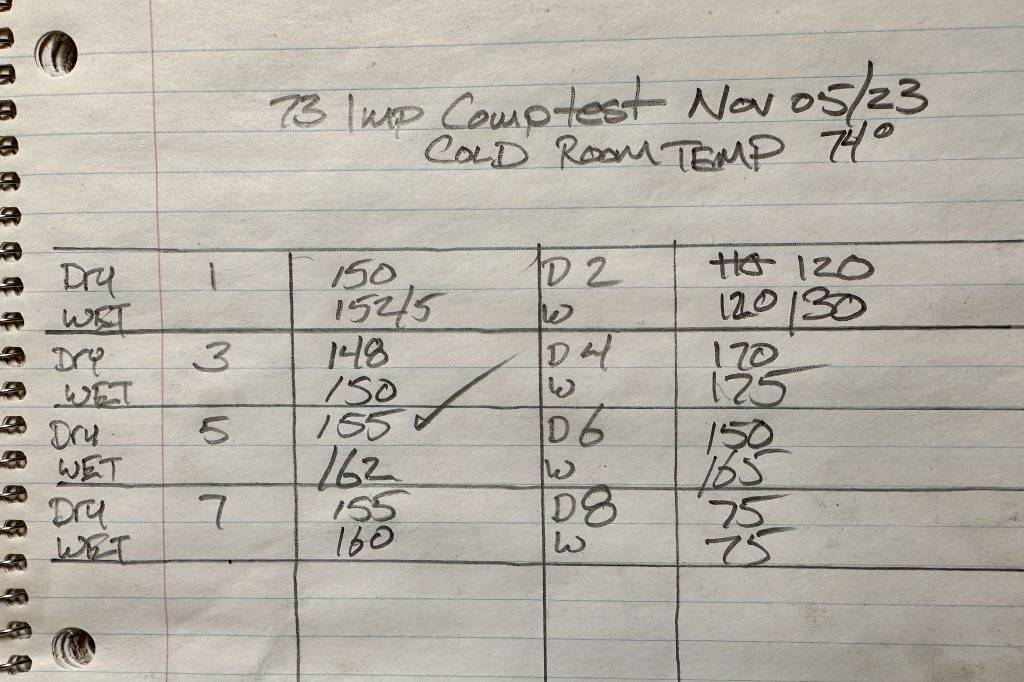

I started with a room temp engine, all plugs removed, throttle open and a battery charger connected to battery. I find out half way that the battery charger is not charging or keeping up. I had to go back and do a few over with new battery charger hooked up and after a while of charging.

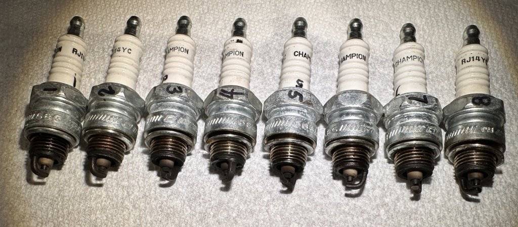

I did dry and wet. 5000 miles for plug install, last few drives were in urban traffic, an hour at a time at least.

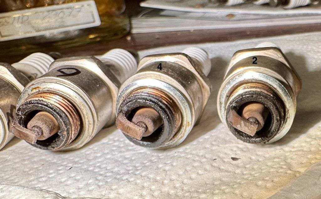

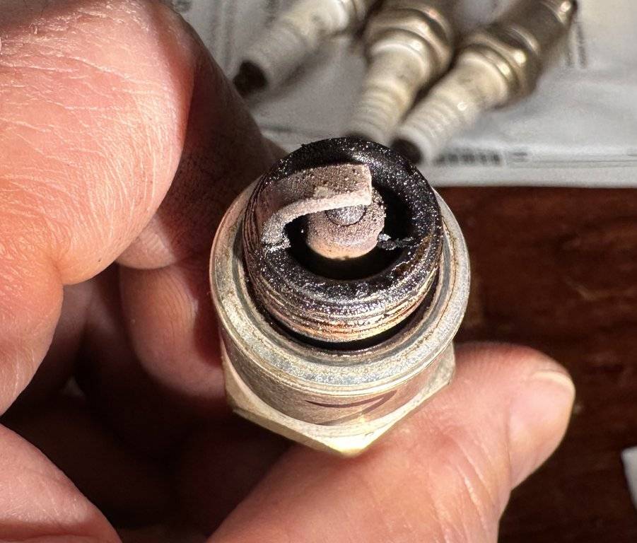

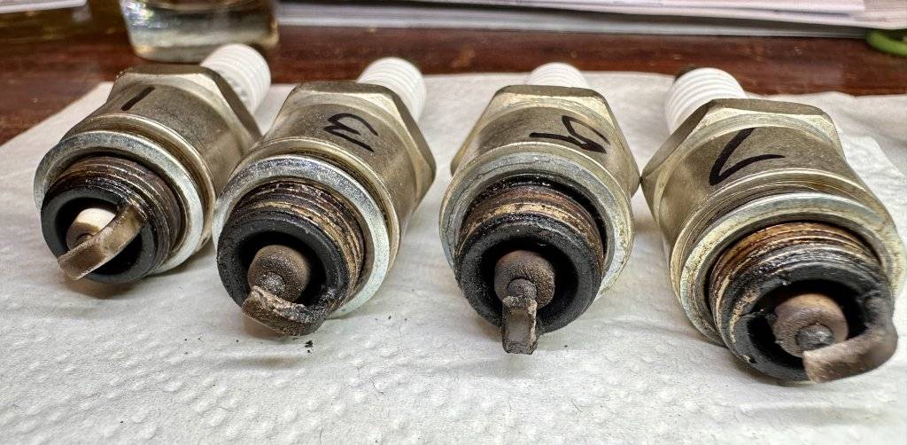

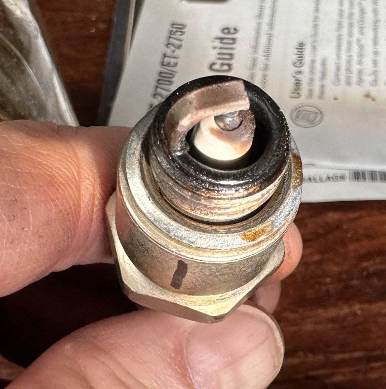

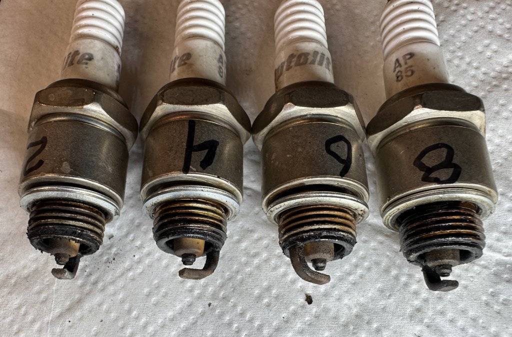

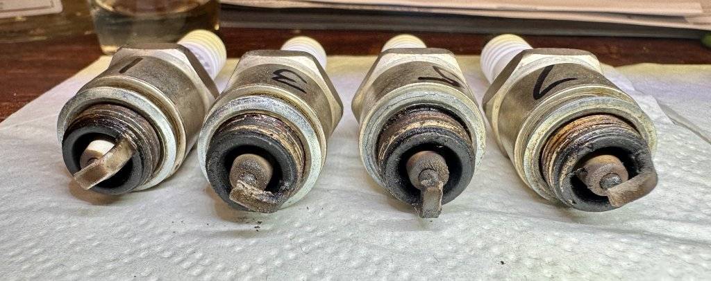

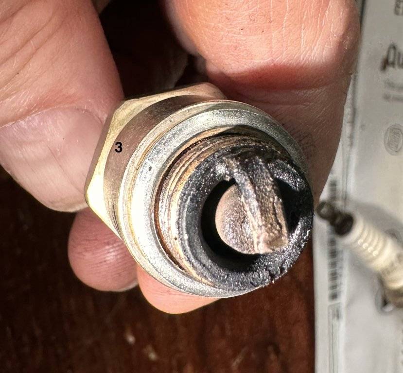

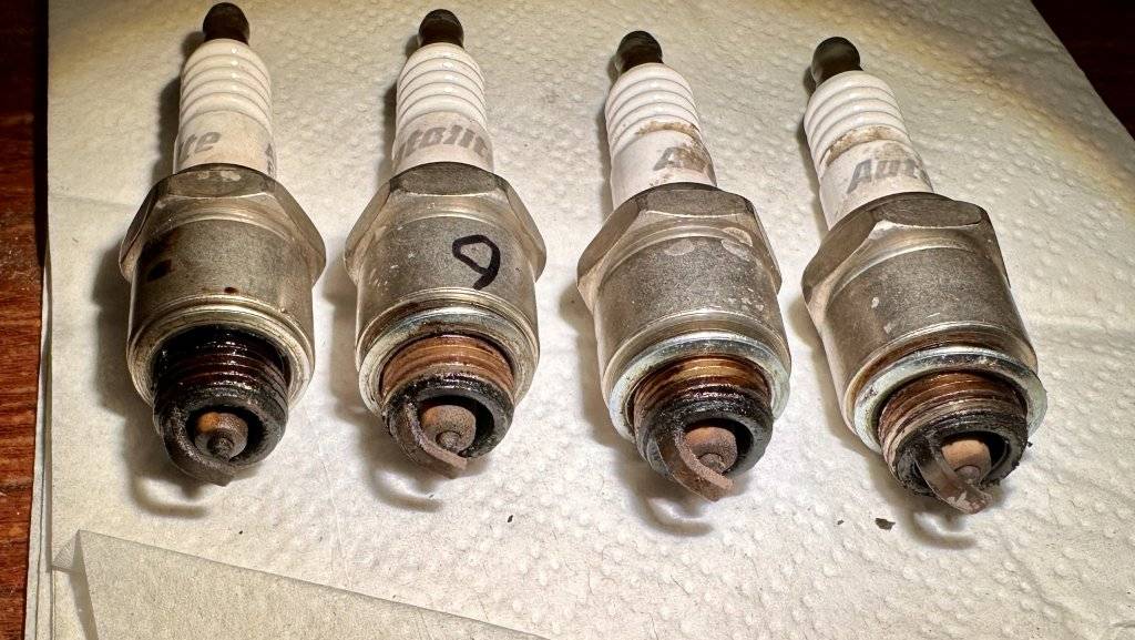

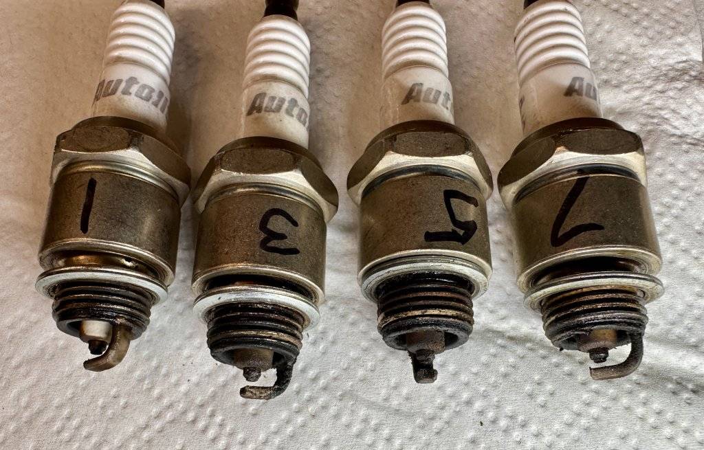

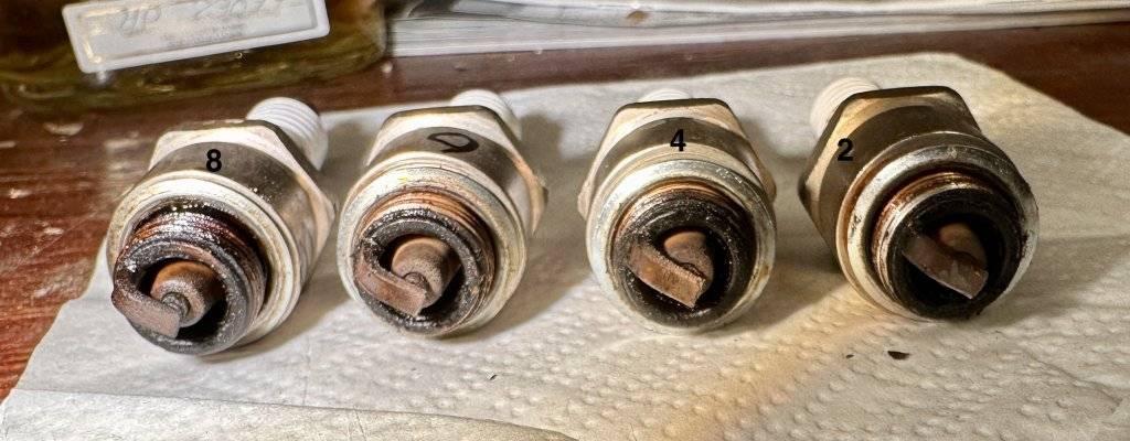

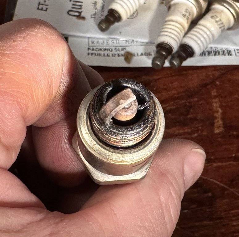

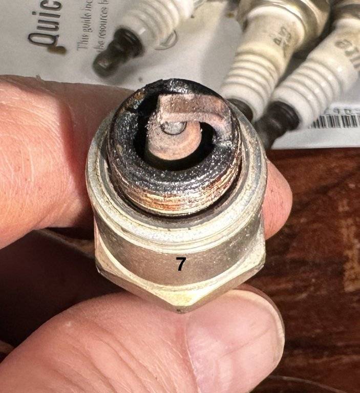

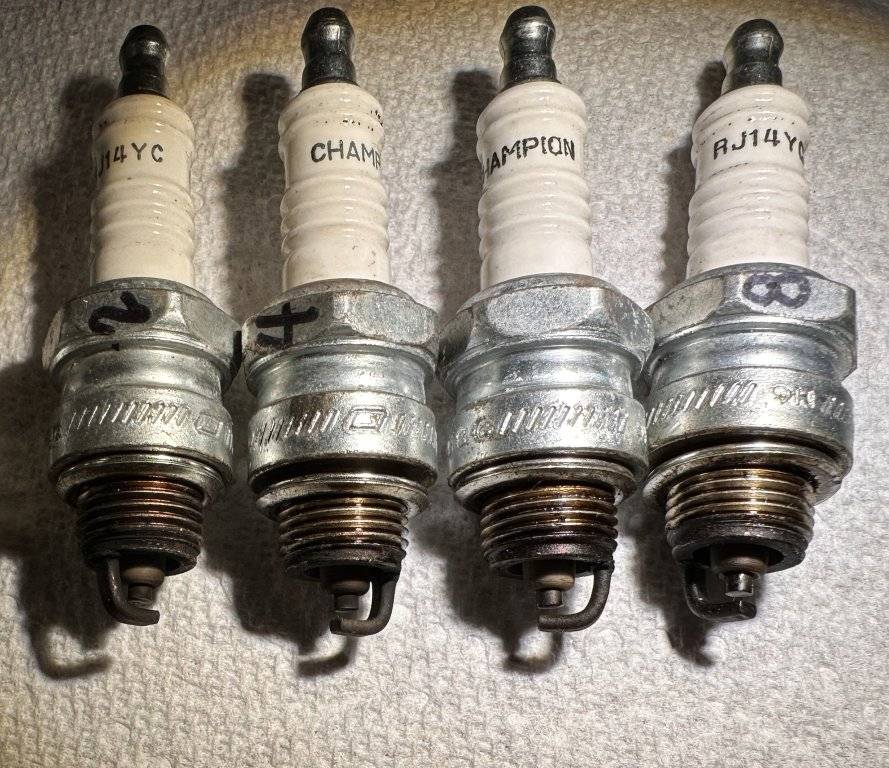

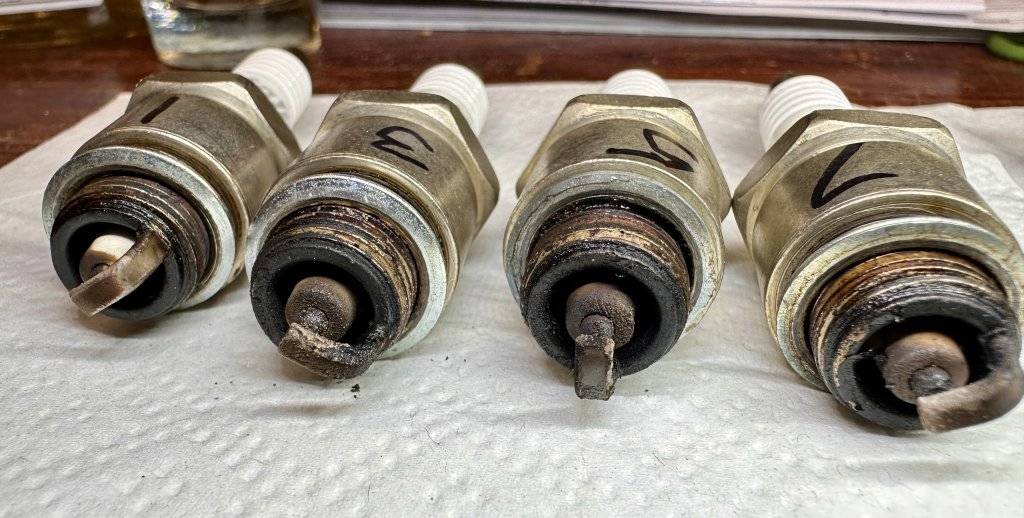

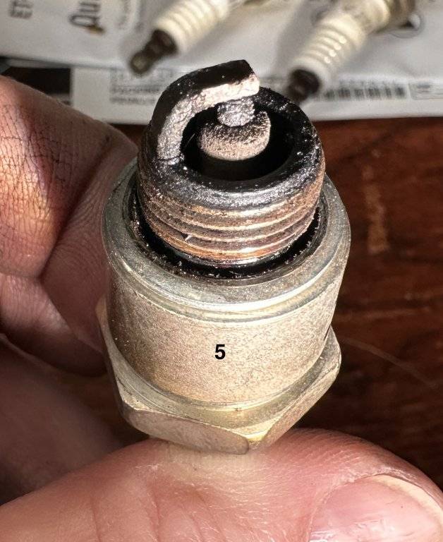

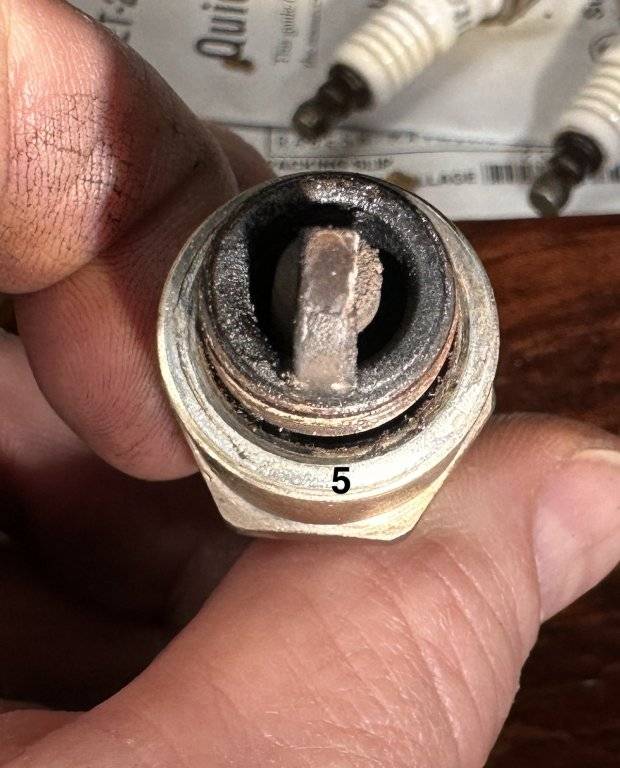

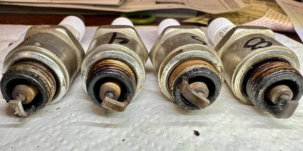

Looks like the plugs are getting a bit wet with oil and fuel additive. (the outboard oil is all that has been added.) I would say too much outboard oil, and seals leaking. Also the gold on threads is copper anti seize, I thought these plugs might be installed for a while. The plugs also are a bit cool, could go hotter. Timing looks good. Let me know what you see.

nothing an engine rebuild won't cure...you've got low compression on 2 and even lower on 8...and signs of burning oil...whether that oil is from the rings, guides, or the (why?) outboard oil i don't know...so you could rebuild the heads and hope for the best and see if it improves the oil situation or go for the whole 9 yards now...depends on your financial situation and abilities
Compression numbers don't look too bad. Obviously #8 has some issues, from the top and bottom of things.
One thing bothers me is the number of plugs that look like they have "sand" on them. Allegedly that is supposed to mean "dirty air filter" that's letting things through that should not be let through. Just looks unusual to see that much "grit" on so many plugs.
Personally, you can clean the plugs in carb cleaner and then knock off any "deposits" on the center electrode and such, then dress the center electrode with a point file, gap to your desired spec, then put them back in.
It will be interesting to see where the oil in #8 has migrated from.

I’ve been raving about it for years, marine 2-cycle TC-W3. It’s to counter the negative effects of ethanol.
I think one once per 5 gallons might be too much. I think some of the deposits are from the 2-cycle oil. But it will need the heads rebuilt. I am thinking the rings are ok as the readings did not change much and this was a cold test.
Honestly I can say that I’ve been using it without missing a fill-up and likely at a higher rate than 1oz per 5 gallons as I don’t dispense pre-measured at the pump. I’ve not seen deposits like that on my plugs.
What is your EGR doing, blocked or still trying to do it's thing?
You have oil intrusion.
Does this car do a lot of short trips?
EGR vacuum line is blocked, I do want to block the EGR when I do the head work. Yes it has been doing some 1 hour max slow drives, just had a tank of fuel go thru in slow urban traffic, 25/35 mph max. It gets lots of highway runs during the summer show season.

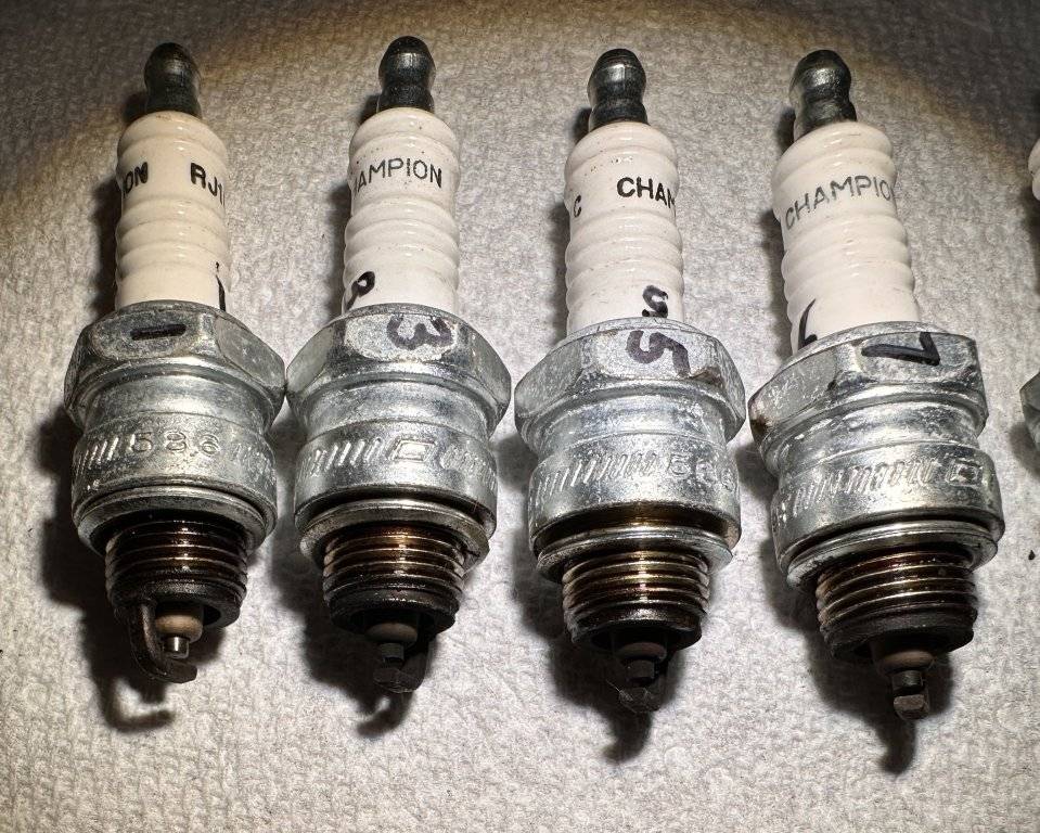

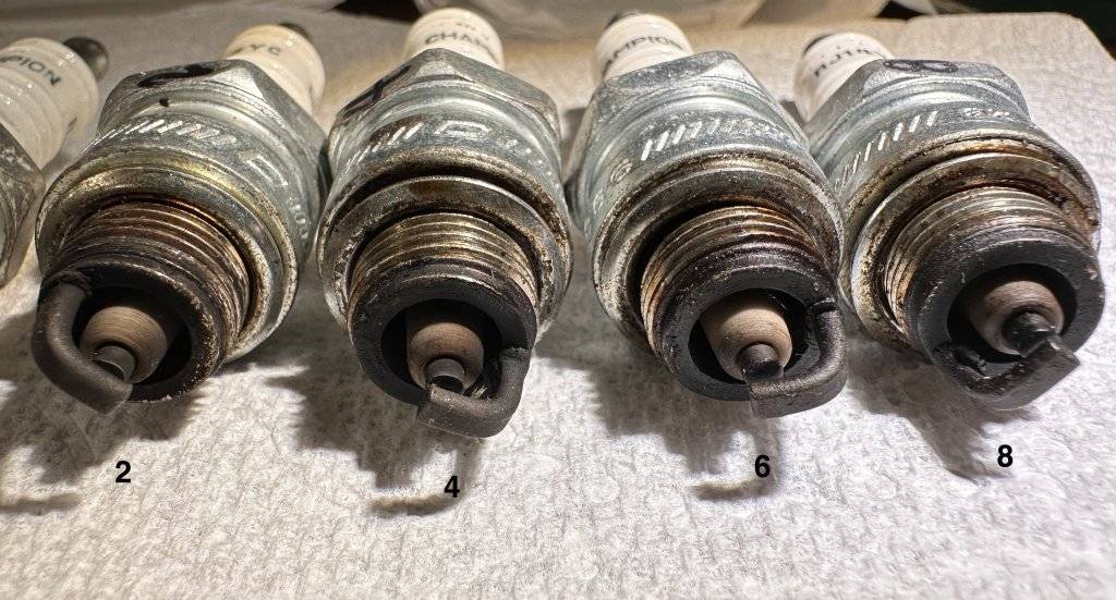

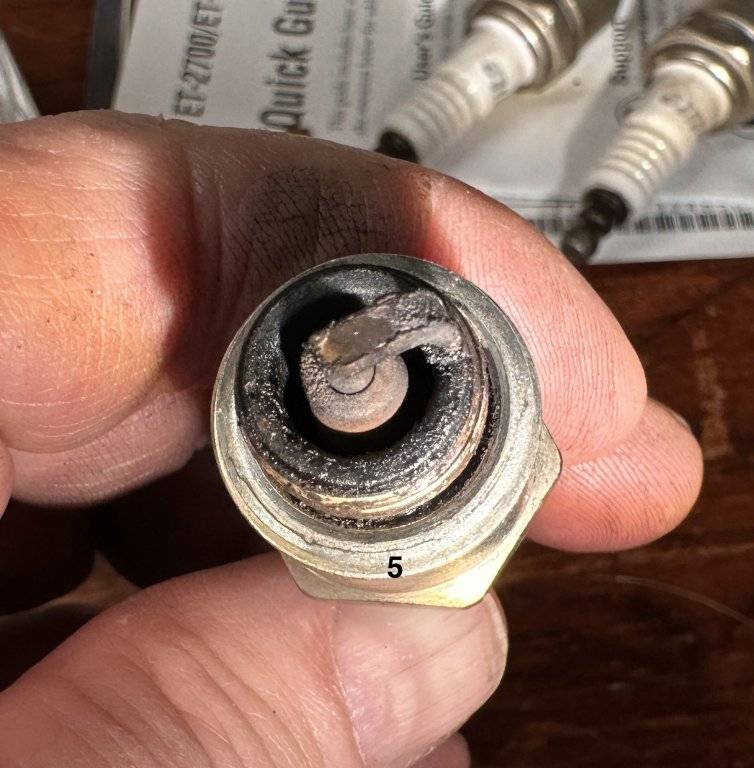

Here are pics of the Champions I removed 5000 miles ago. I think the Champions were in for maybe 1500 miles.
I have always known number 8 had a mis fire, I finally made time between clients to get some of my maintenance caught up.
