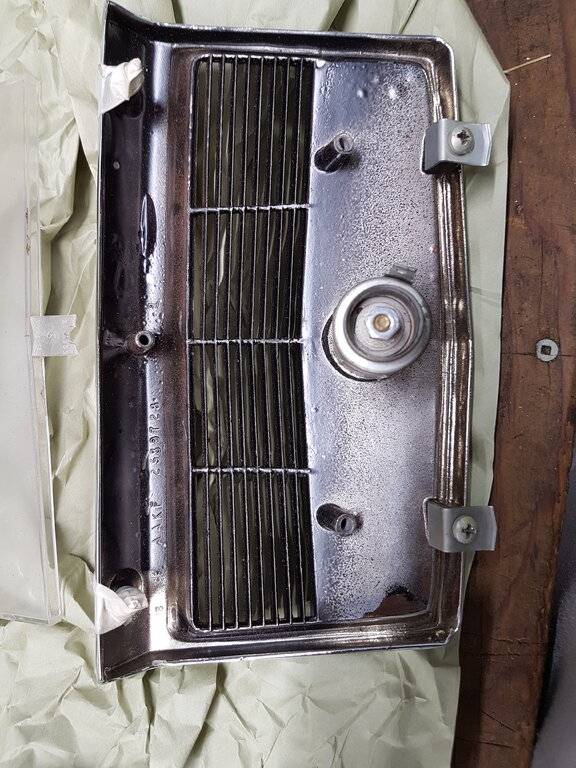

I'm curious about the cigar lighter and light options that some consoles had.
I have seen pictures of the finish side with the light on and cigar lighter, but I'm interested in seeing the backside and light mounting and any additional differences.

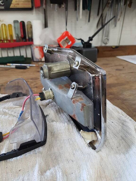

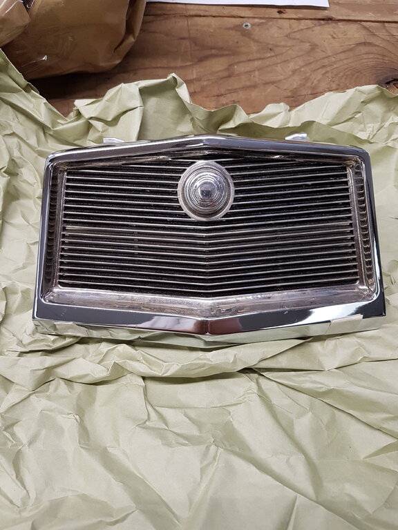

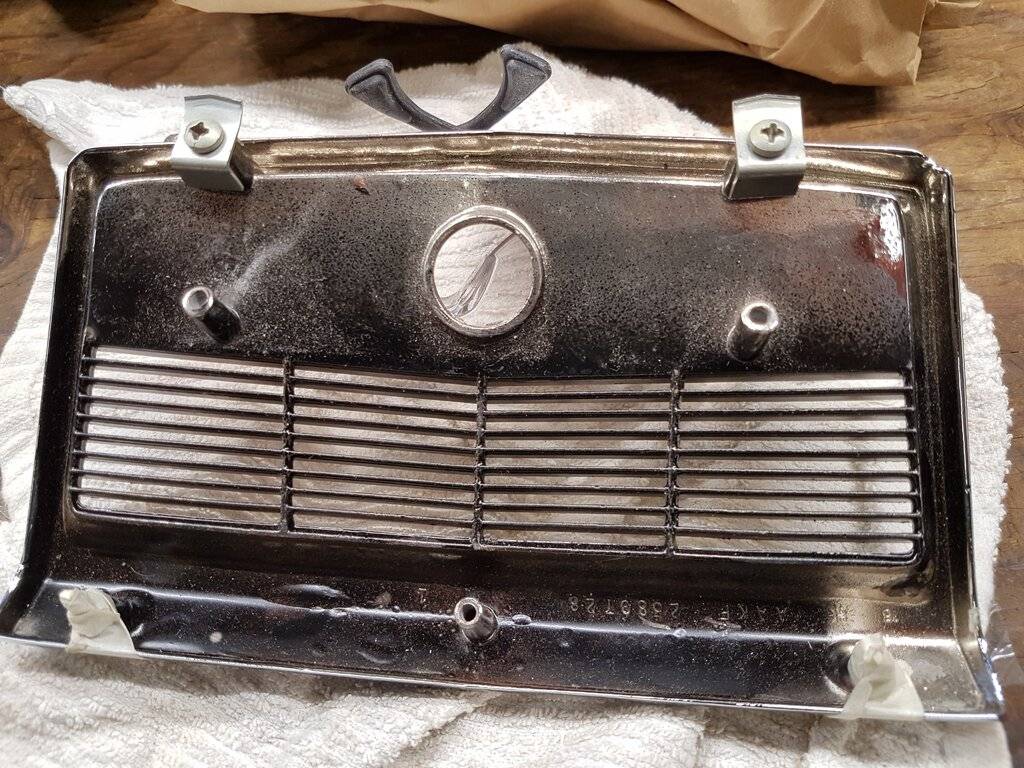

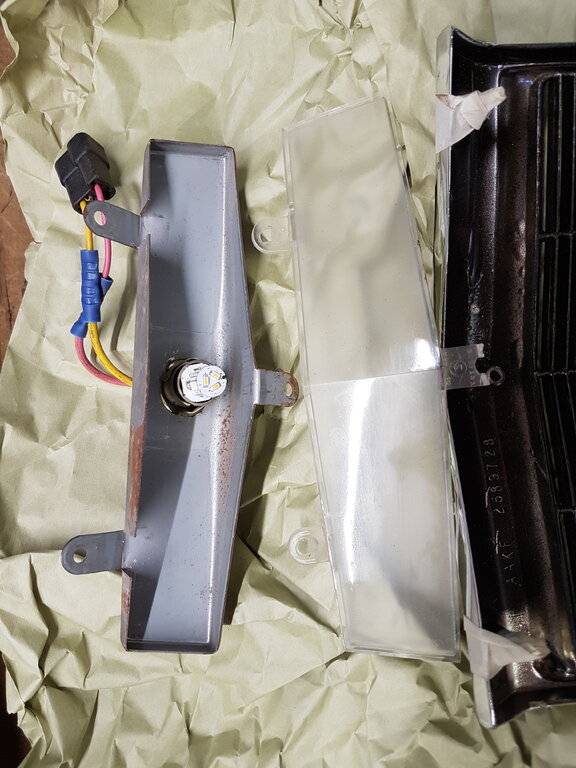

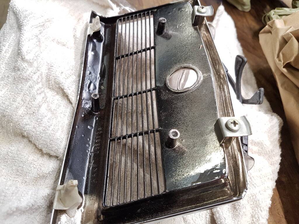

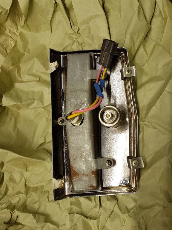

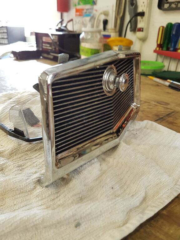

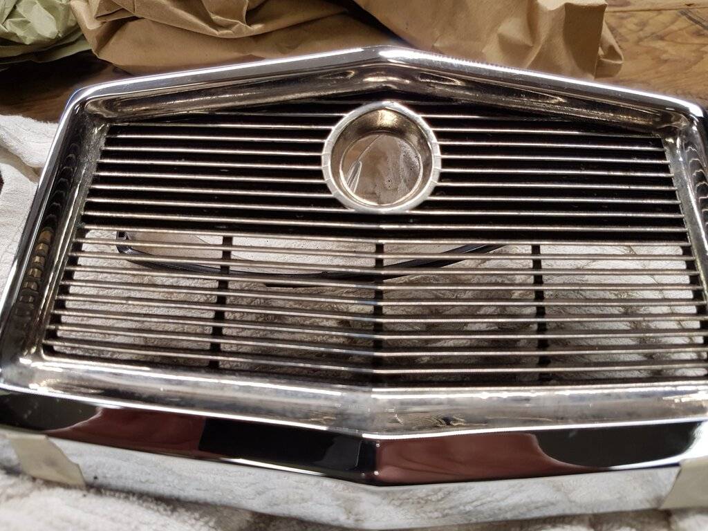

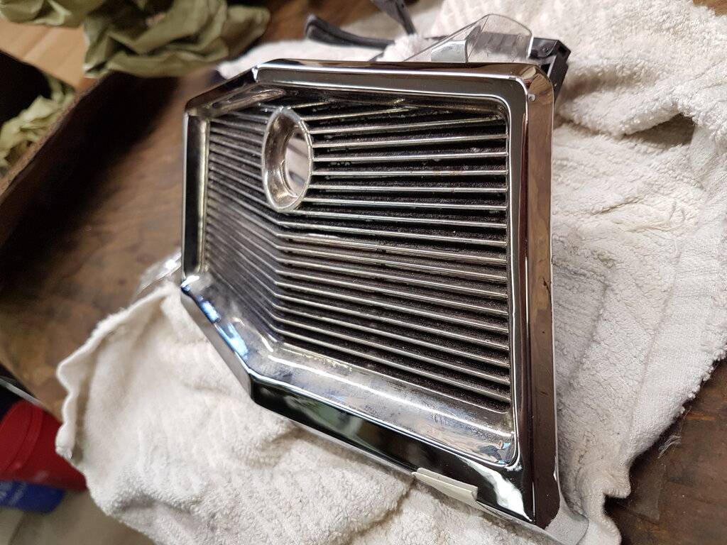

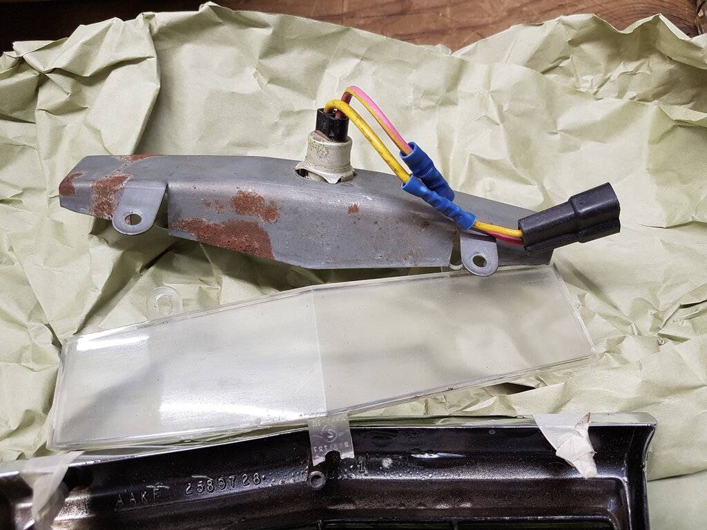

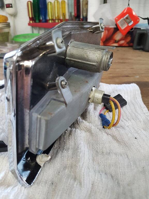

Here's mine (not for sale - sorry). It was missing the bulb socket, so I had to modify another bulb socket to fit, and modify my console harness to splice it into the courtesey lights. Same with the lighter feed - I just ran a 10 AWG wire from the circuit braker for the power seats/windows in the kick panel.
Hope this helps

I've been looking at ideas on how to make the light housing and would like a picture from the side (installed) showing the clearance with the lighter and the relative angle to the end plate.
It would be helpful to see it without the cigar lighter housing installed, It would be helpful to see if the casting was modified or if there was a sleeve installed.
I understand I may not be exact but I feel with enough information I should be able to get close.
Thanks,
