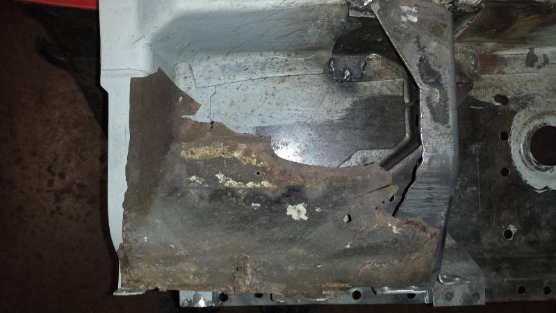

I plan to make some for my 66 Polara. They will not be a factory look but functional.
I'm on the sidelines right now with kidney stone surgery but hope to have these done in the next month or so depending on how I recover.

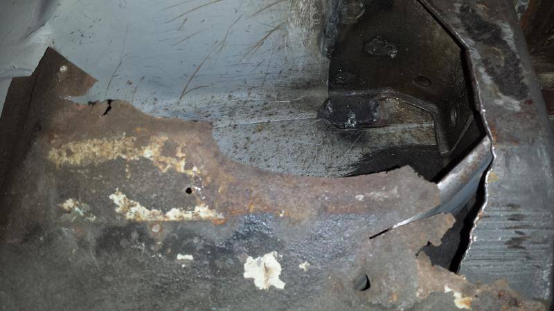

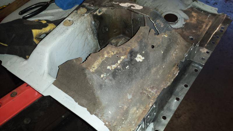

I have over-layed the one that kind of survived.
You can see that there was an oval like hole that allows access to the front spring brackets and there are multiple angles used to create the torque boxes.
the Fury boxes would be 3 inches longer possibly because they use a shorter leaf spring in the 65-68 models
All Chrysler convertibles have torque boxes. All Hemi cars also had them.
