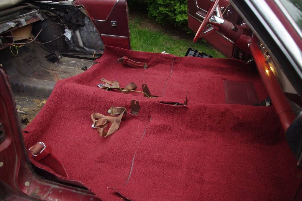

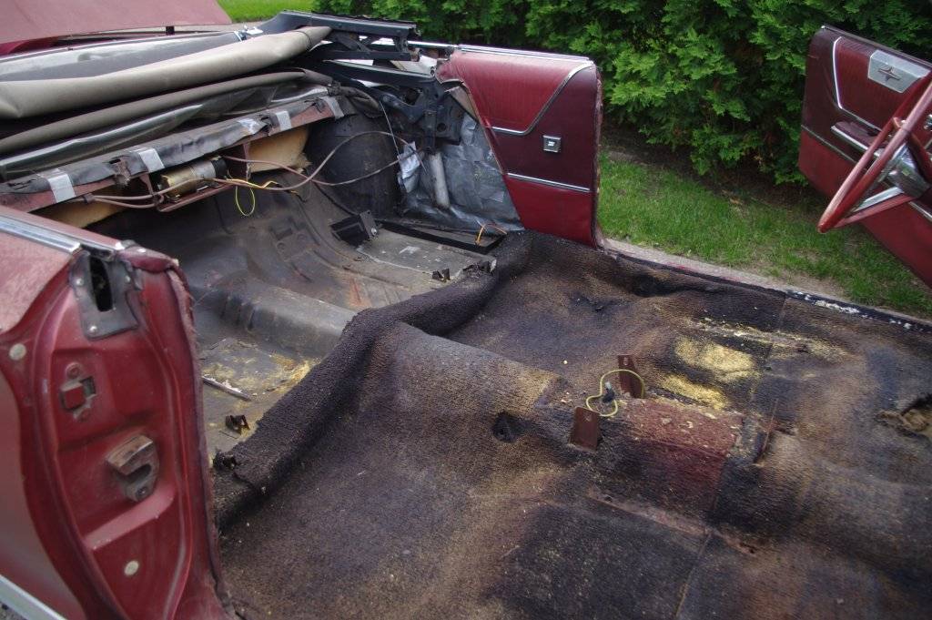

For whatever its worth, this "black" carpet was originally from a hardtop, and the red is what I ordered that was described as fitting a convertible. They look pretty similar to me, but the black was original 1965 factory carpet. Maybe the ACC stuff is cut shorter?

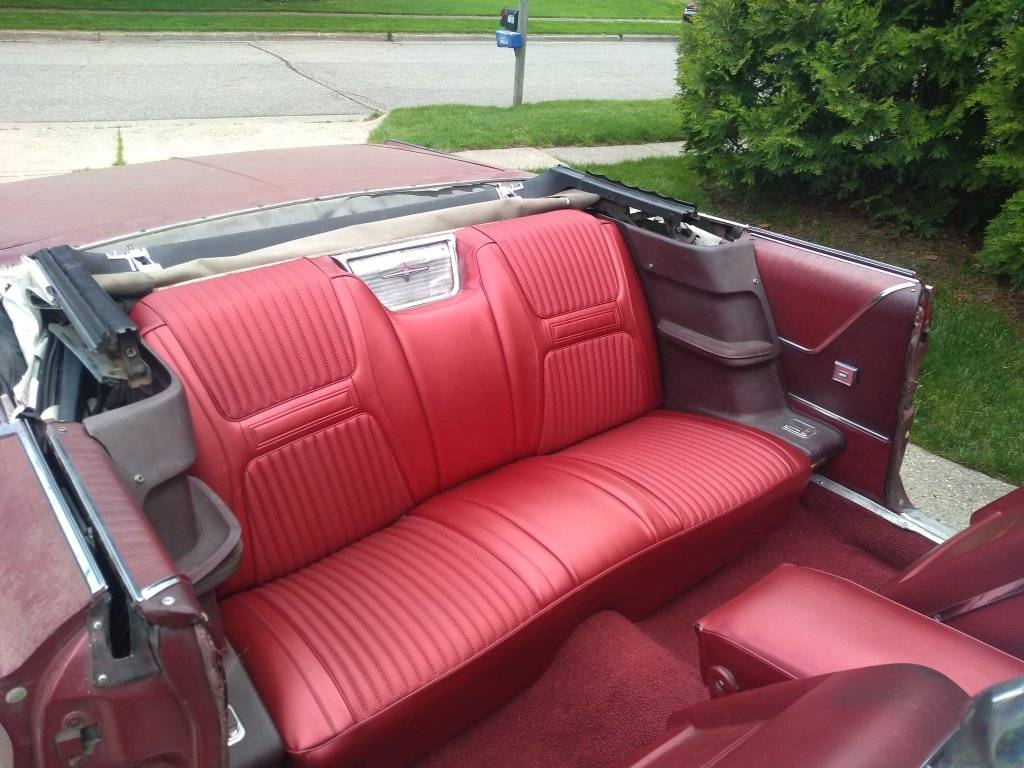

I know the seat is narrower, but it seems like the fiberglass side panels cover most of that area anyway don't they?

Thats what I was thinking too. The 4 door carpet is longer on the ends to extend around the curved ends of a 4 door's back seat. I was considering a 4 door carpet for that reason. but wasn't sure if that would be factory cut for a B pillar.
Pretty interior by the way.
