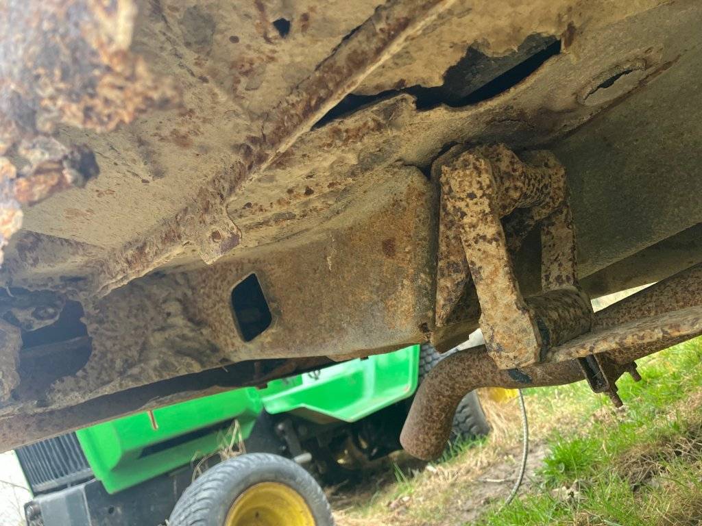

sorry, underside is pretty crusty!!

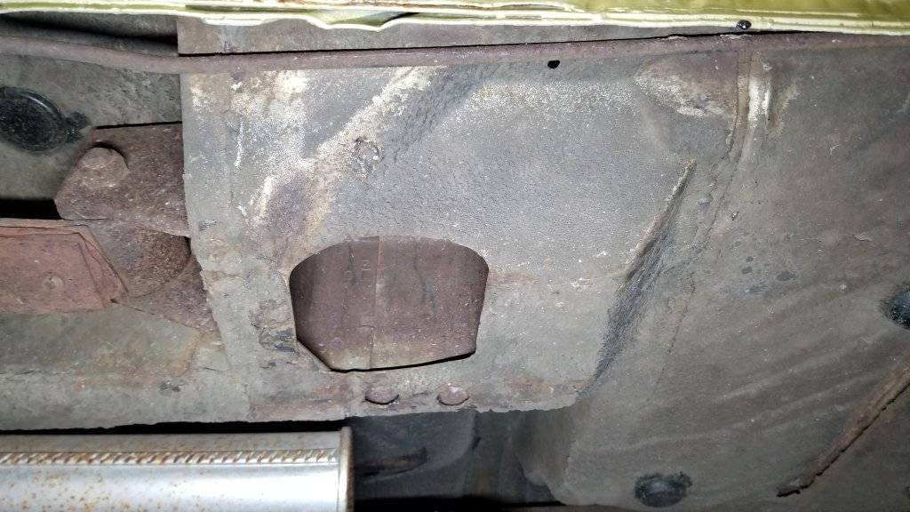

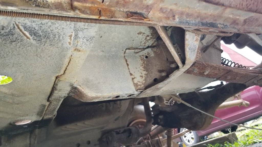

My apologies for not being clearer. I mean the plates that box in the forward leaf hanger bulkhead.
Factory torque box:
Without torque box:
I'd be interested in those added plates cutout at the factory seams so it can be welded into another car if it's in good solid condition.

67valiant- sorry too crusty, The top half of this car including entire interior survived well but lower half is toasty

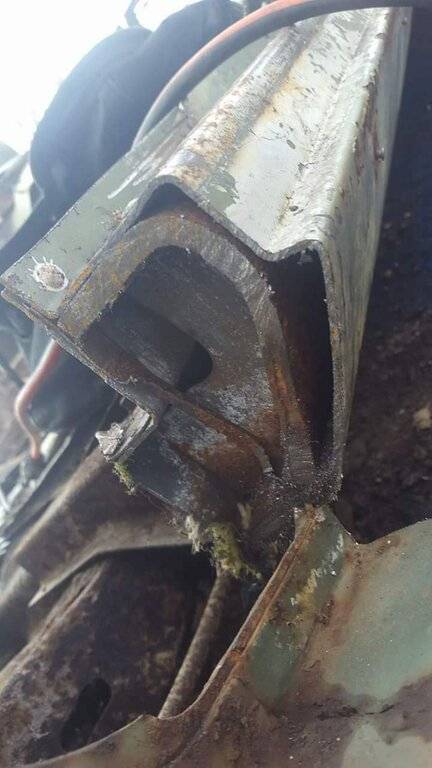

This is a Dart convertible rocker but same idea. The thick C-channel inside is convertible specific.
learned something new!! Is it spot welded to outer rocker?
Removing this to be useful might prove tricky. It is all welded together at the pinch welds and on the ends. You can't just cut through (like the pictured example) that would render it useless (as well as ruining many saw blades). It would have to be removed from each end at the factory seems, dog leg to dog leg. If you have a torch you can cut it out easier, but you still need to keep it structurally intact.

Interesting, thanks for that photo. Many years ago a member of this site posted a similar shot, but of a C body and I seem to recall the channel being L shaped, I could be wrong. The C body channel is twice the thickness of the A body one, that much I'm sure of.
And I agree with Samplingman, removal may be tricky, I've never done it.
