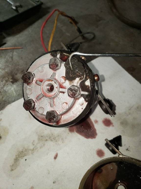

Thank you again for the info. I pulled the pump out and ripped it apart. Nasty stuff inside.
After thoroughly cleaning the pump side I decided to pull the armature out to inspect it. Taking it apart was easy, putting it back together required some creative use of duct tape and fishing line. My recommendation for those of you who may decide to take your pump apart to clean it, leave the motor side alone! Even if it is the motor, it doesn't appear to be serviceable. I did clean up the copper where the brushes ride but I doubt that made much difference.
Everything is back together with new lines and fresh fluid and it seems to be working well. Of course I think the dash switch itself may be going bad but that's a job for another day. Probably just needs to be cleaned up.
