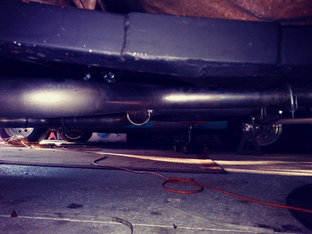

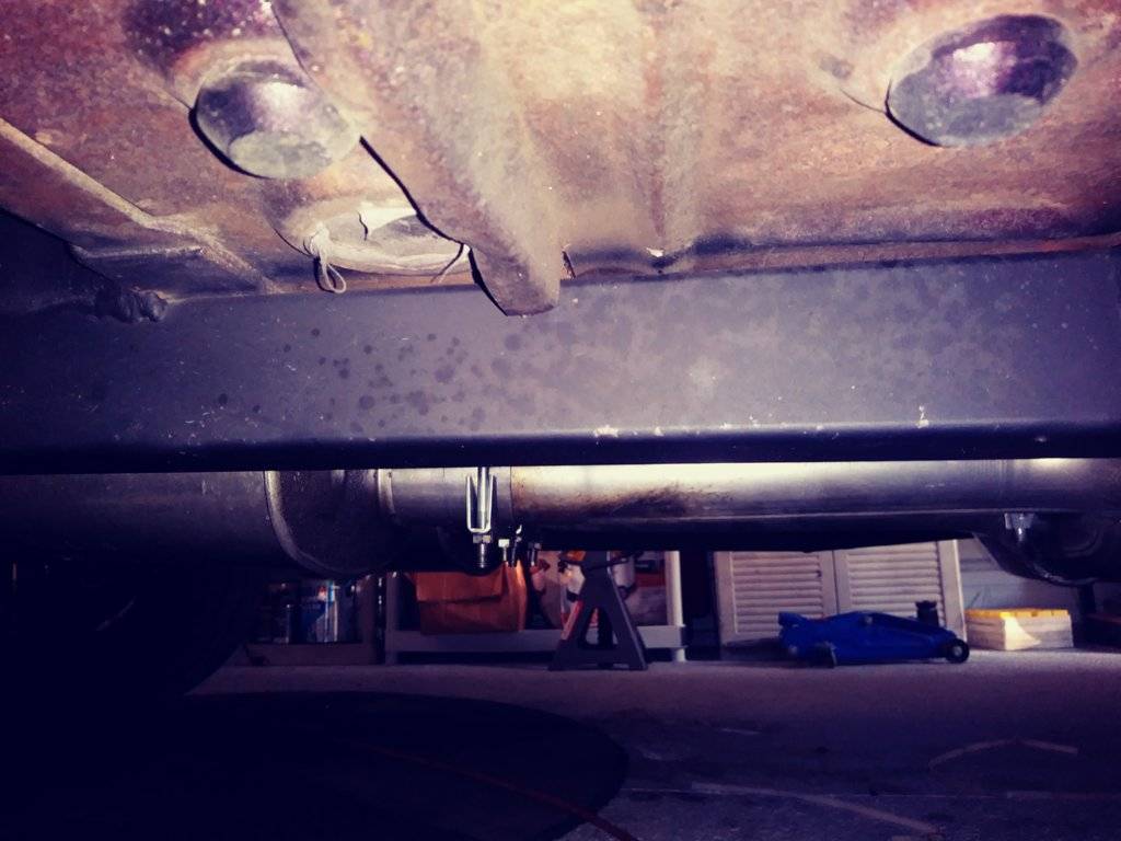

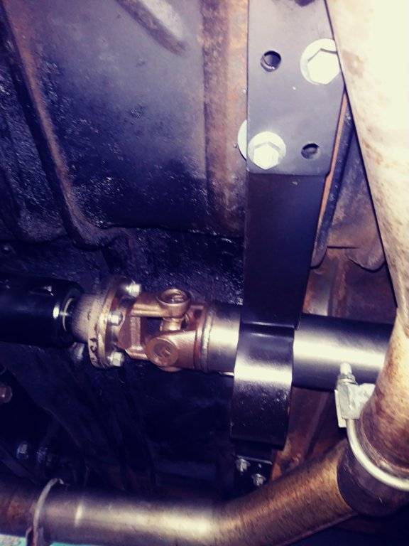

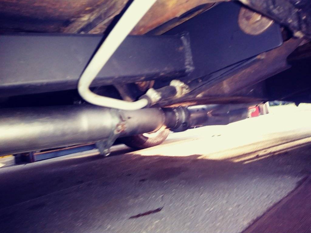

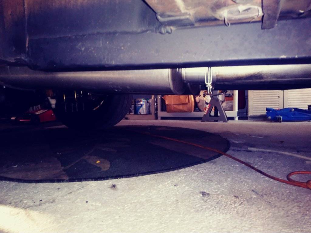

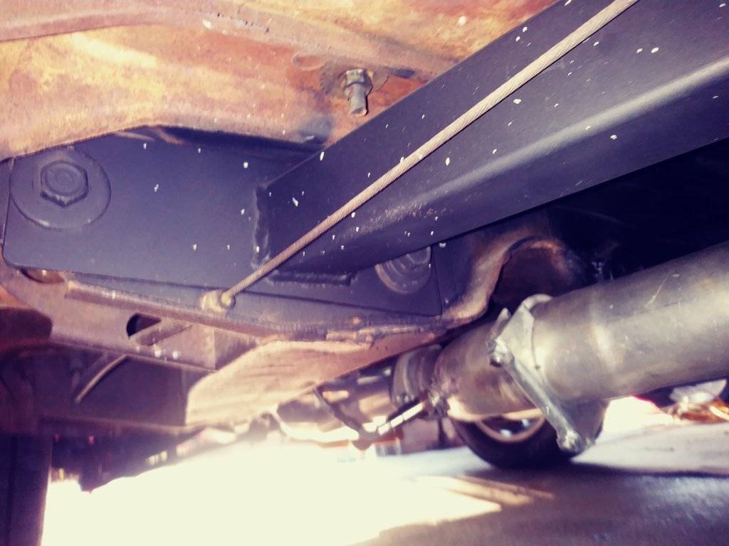

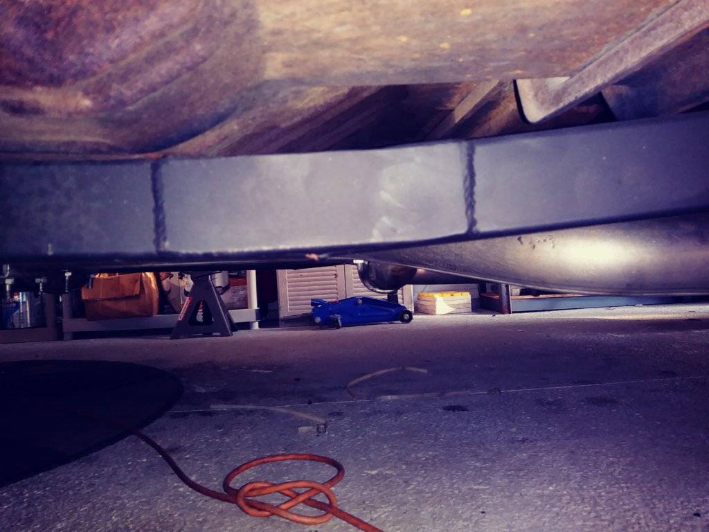

Hey Mike,here are some pics of my s(T)ub frame connectors. I also did a driveshaft safety loop.
Pics are crappy, hope you can see how they are done.
Basically, there is a compound angle in the middle, but, not too tough.
The stiffness is noticeable in a good way. Mine are done in 2x2 thick wall. there are a couple lips that had to be cut out, but really minor.
The safety loop is a generic piece scabbed onto the side of the forward rails

Thanx Doug, the pics are great.
View attachment 191608 View attachment 191609 View attachment 191610 View attachment 191611 View attachment 191612 View attachment 191613 View attachment 191614
Hi Doug, the pics are great. Nice job on the connectors.Did you use the original bolt holes on the crossmember to mount the front connector? Thanx for posting these.
Yes I copied some ideas I had seen, worked out great.
Making sure the parking brake cable worked was one of the biggest considerations.
Once you get under there measuring, cutting, and fitting, it all kind of falls into place.
