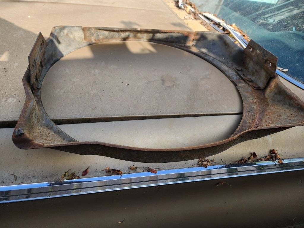

Hello C-body folks. I need a fan shroud for my '65 new Yorker. It didn't come with one when I bought it. Does anyone know of a used unit I could buy, or is there a new unit out there?
Everything was fine until I installed an aftermarket AC system. SO, I had the factory radiator re-cored, but that didn't cut the mustard. THEN, I bought an aluminum radiator unit from Engineered Cooling Products, and overall things have been OK. BUT, with the stop/go of Tampa traffic and the long traffic lights and the blistering heat, the HOT light comes on sometimes; the car has not overheated, but I'd like to be sure it won't.
I bought a shroud at a swap meet, but it turned out to be from an A-body. I offered that shroud for free on the A-body forum if the recipient would just pay for shipping; I trusted the guy and sent the shroud, but he never paid. But I digress.
Any suggestions for a shroud for my '65 NYer with 413? I much appreciate any helpful input.

Sorry to say that factory shrouds are hard to come by unless someone is repopping them now. I went through this a few years ago. My fix was to add a high-flow water pump, flush out the system several times, add in a 50/50 blend of distilled water and Mopar rated anti-freeze. I use a 195, but maybe in Florida a 180 would do better because of the heat.
Bottom line, these engines do run hot in the heat. Mine gets a little iffy in traffic in August and September as well.
Hopefully some of the other guys have better advice, because if someone is making shrouds, I'm considering that route. In the mean time... what do you think of the radiator you bought? I was looking at those a few weeks ago.
