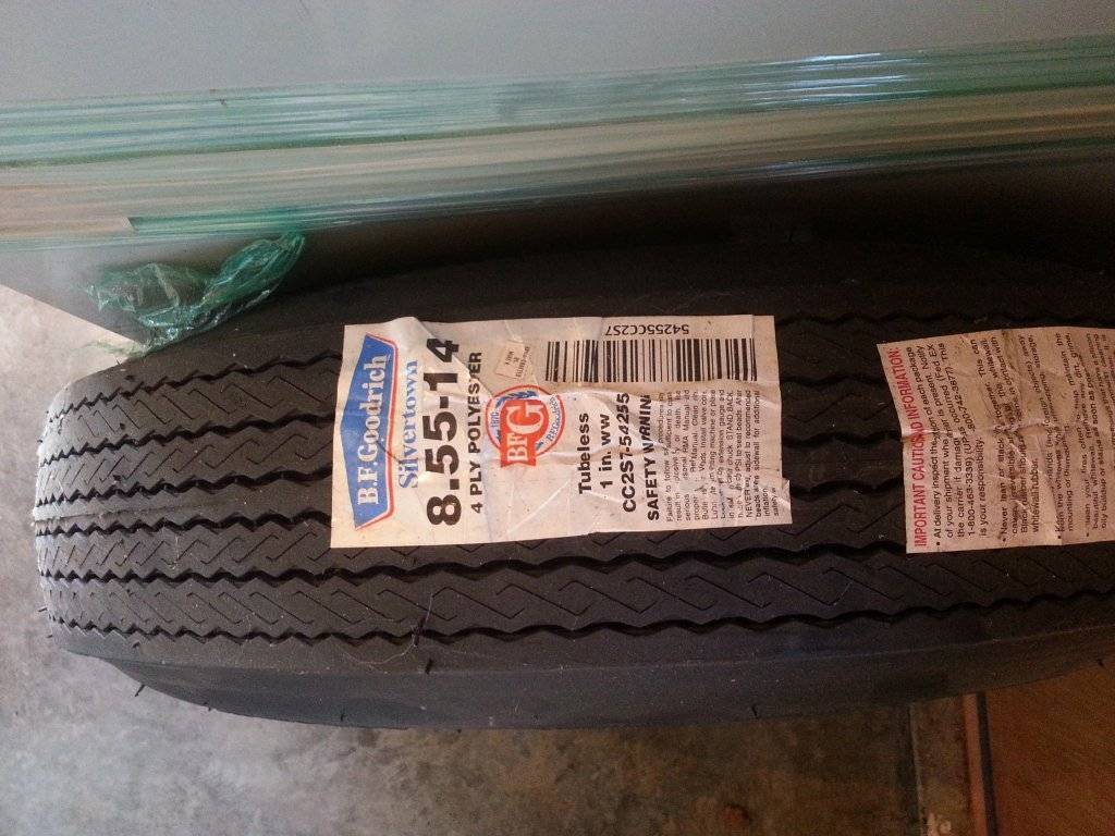

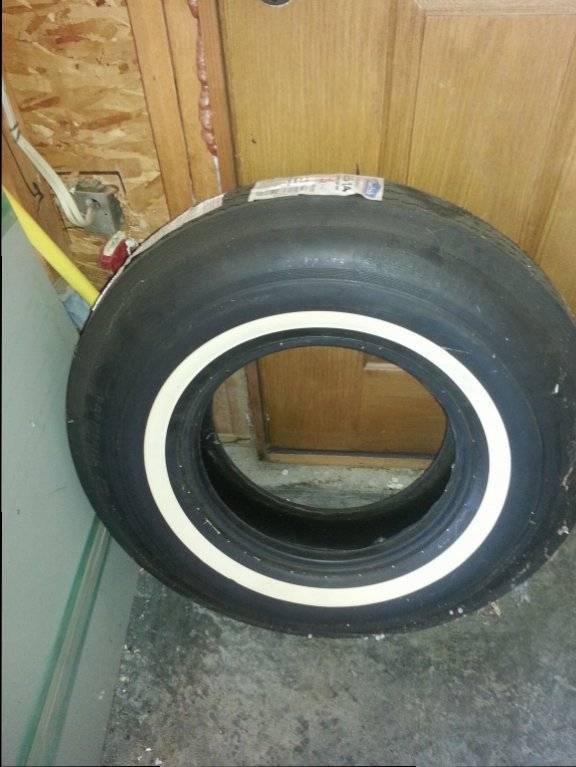

Here is what I have on the 65 Monaco...fits the original rims.
