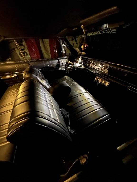

NOS map light showed up and installed already! This made way more of a difference than I expected for nighttime interior visibility.
