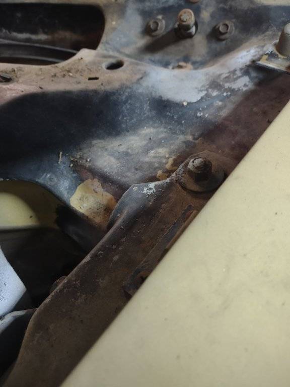

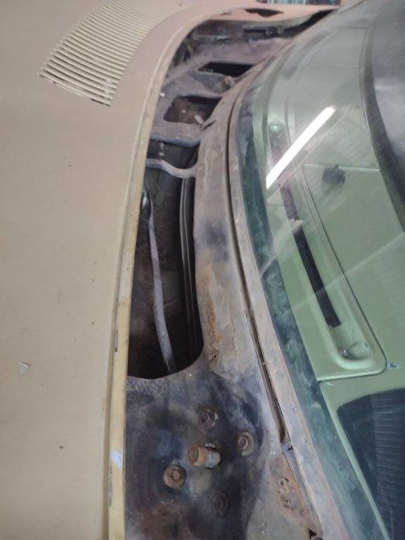

Does anyone know what color cowls were on 69 300. Im told body color but mine appears to have been repainted black.

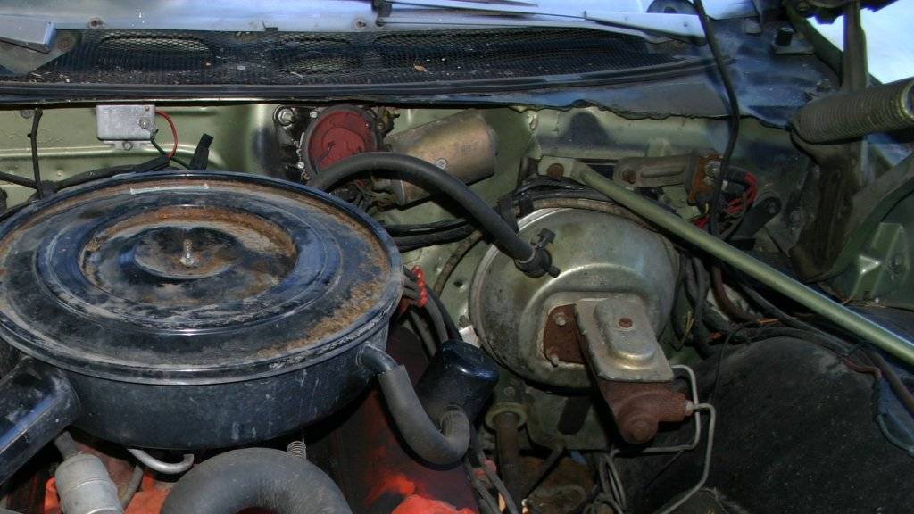

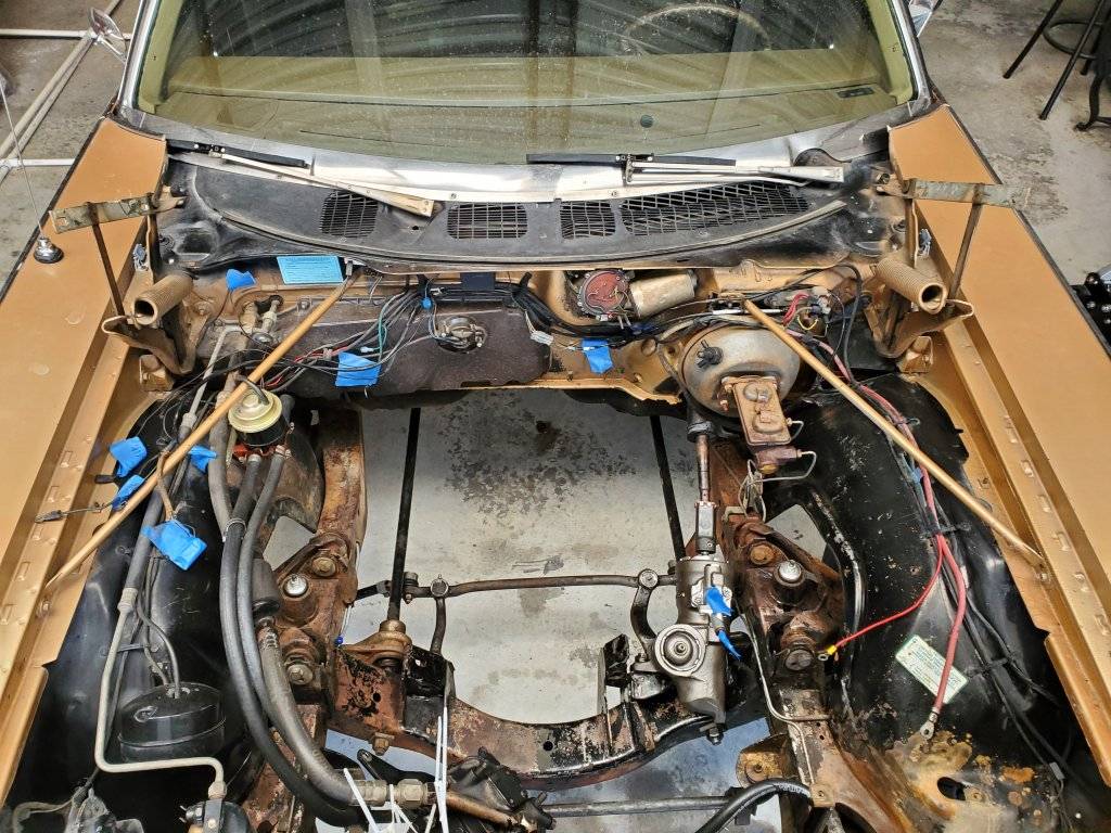

Like the core support the cowl was sprayed black on lighter color cars.
Here is a 69 Polara I had. It was sprayed at an angle that may get overspray on the face of the firewall, seen by the wiper motor, above the booster and by the hinge.
