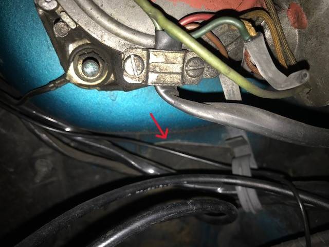

Here's how the water stays out. The lowest portion of the cowl has this little rubber flapper valve (red arrow) that lets water drain out (normally), the air inlet for the cowl vents is above this, so water should all drain out and not get into the vents. When the drain gets clogged, water backs up until it can flow down into the vents. I used a hanger to "open up" the drain and then flushed it out really well with water. This was probably 5 plus years ago and I haven't had the issue reoccur since. Car is kept outside all the time.
At least on a fuselage body, a poor design in my opinion. However if this gets clogged the water will flow horizontally and drain out the sides and exit via the lower cowl drains, located behind the kick panels/rear of fenders. Not sure what year car the OP has or how the other eras are different. But important to keep this clean in addition to the lower sides of the cowl where debris also becomes lodged and blocks the drains.

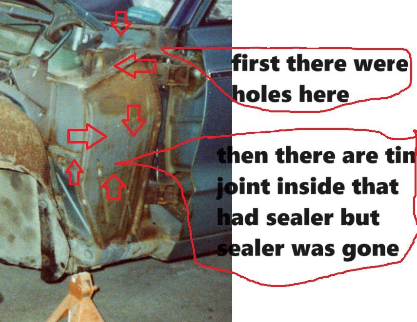

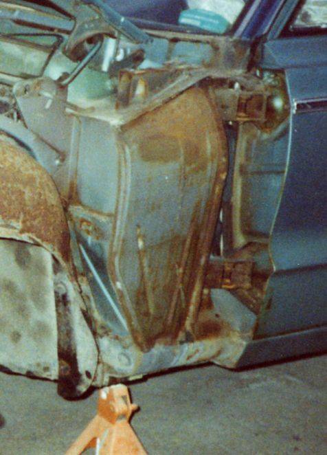

I've had water entering from vent and geting the carpet wetWas cause by rust holes on cowl, afer fixing, it still was leaking, fond out by having water running in cowl and with a mirror looking up true the vent I saw water comming in from the tin joint insinde the vent
