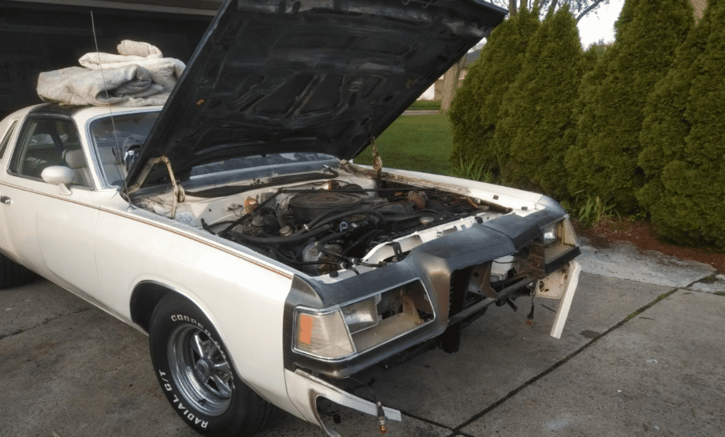

I'm repairing a non-C body after a minor wreck last fall...

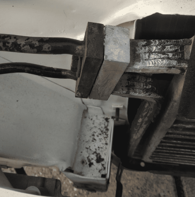

I lucked into finding a non-rusty 79 Chrysler 300 in a local pic-a-part and scored a lot of parts, including an a/c condenser. I grabbed this one because the only oily area was at the connection/seal, thus indicating that was a leak the last time the a/c worked. I would like to clean this oil buildup, but my normal "go-to" for heavy grease (Oven Cleaner) is a no-no for aluminum (I think?). Keep in mind, heavy mechanical motion isn't an option because of the delicate nature of the fins. Any ideas on how to clean this part? The part that looks like it's made from volcanic ash is supposed to look like the fins to the right.

Light application of heat - (hair dryer) to soften the buildup, scrape the main part of it away with a plastic scraper. Use Castrol Super Clean or something similar to remove the residue, and you should be able to get it off. Good old lacquer thinners will get the rest.

As dried as that accumulation appears to be, I concur with the plastic scraper. Or, even a flat-blade screwdriver used carefully and gently. Then probably a shot of cleaner for the residual stuff. Once clean, then a light polish with steel wool or light green ScotchBrite, followed by some clear battery protector spray (clear paint) for preservation (on the exposed tubing only).

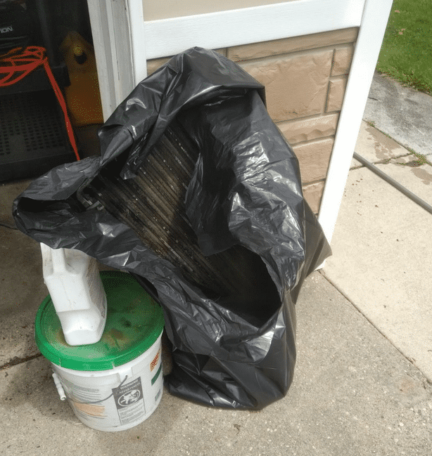

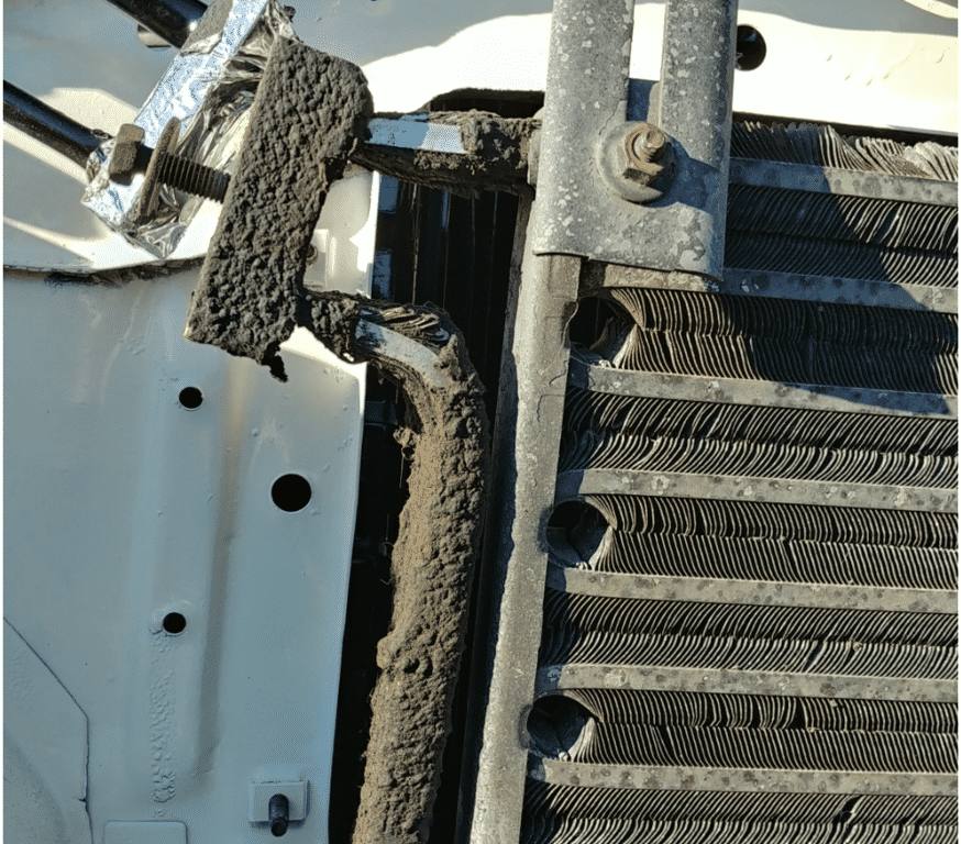

I used the idea of applying some heat and a light scrape on the no-fin areas.. Then I put the hottest water I assumed wouldn't melt a thick trash bag + some "purple power". I let that sit in the sun. It stayed hot for a long time. Removed from bag and used a moderate brush. It came out pretty well I think.
Opening the system revealed that it was very, very dry. However, it will be a long time before I care too much about getting the air going. Frankly I wish it didn't even have a/c, but I don't want a "kludge" of half/half parts.
Keep in mind, this part was originally painted black. I'll touch it up as necessary. The impact bent the lines a little more than I expected. I might just seek out new hard lines since the AC isn't a priority. I actually have both ends covered in aluminum tape.
Here are some before/durings
