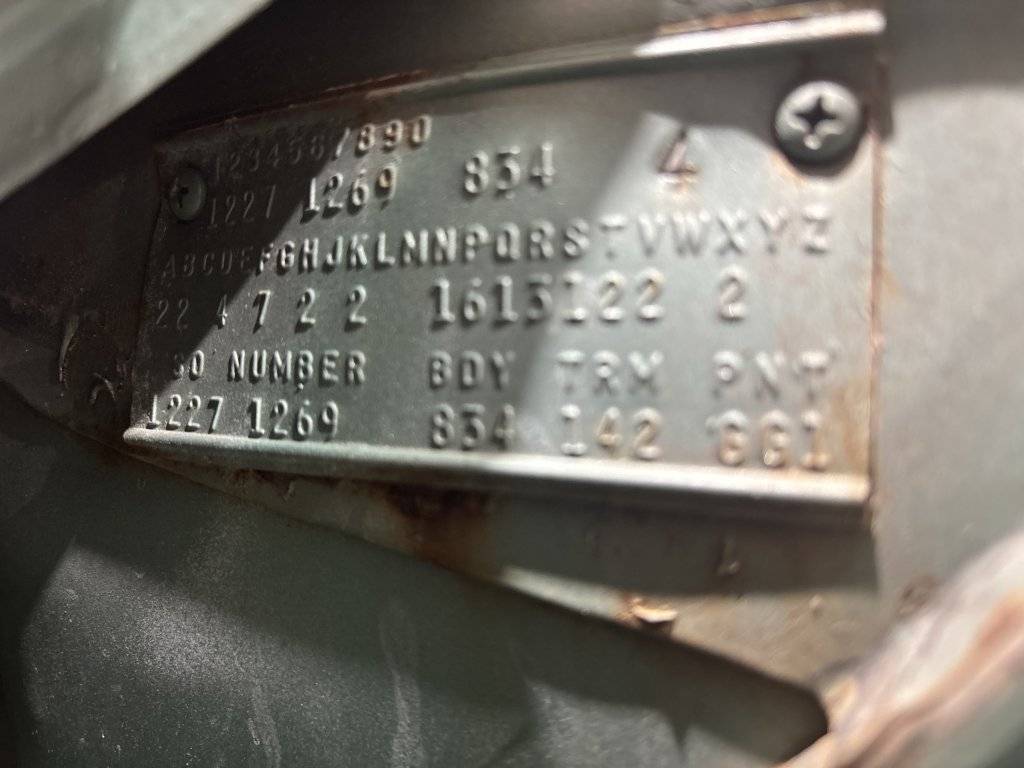

I need experts help on here decoding fender tag of this 1963 New Yorker, thank you in advance
BDY of 834 is 4 Door Hardtop
PNT of GG1 is Surf Green
If you're able to find the assembly sheet in the car, it may be a bit easier to determine some of the options.

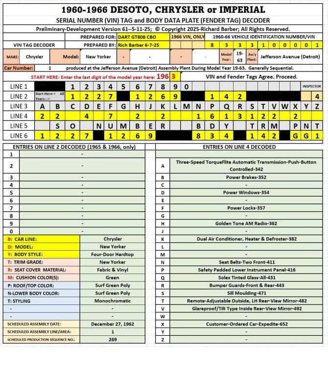

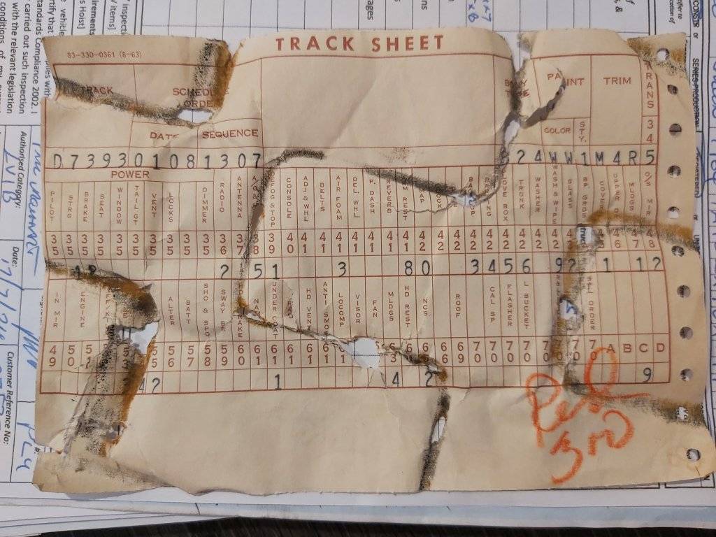

I humbly submit this report from my under-development combo VIN & Fender Tag decoder. Pretty cool (no pun intended) dual air car. Be advised 1963 fender tags are Body Data Plates and do not include information on the engine, differential, tires, wheels, suspension or other chassis line items. This information might be found on a PRODUCTION BROADCAST SHEET-sometimes found tucked in behind the springs of the rear seat upright cushion. I don't have a 1963 example so have attached an assumedly-similar 1964 TRACK SHEET for a '64 300 4DHT I can't quite read the letters under PNT but GG1 was my best guess. I fabricated a VIN to complete the report. Please advise of any errors or omissions.

This is amazing! I think it’s what it is. I’m actually in a process of buying this car, trying to cross check some history and details of the car. This shows so far all matches, thank you very much!
