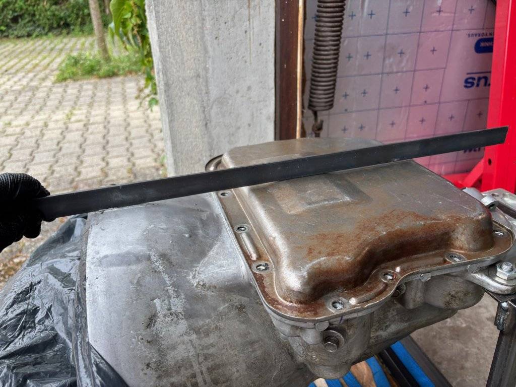

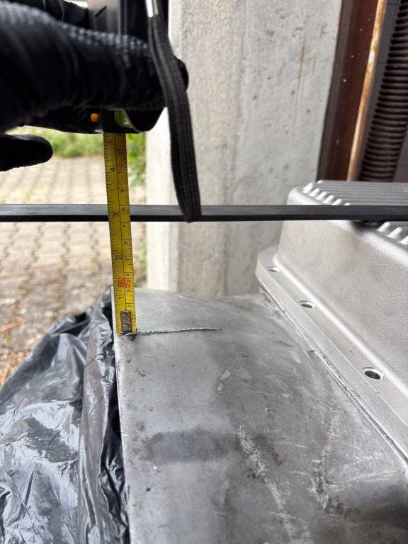

I got a Deep trans Oil pan, for just 2 Quarts additional Oil capacity, but it measures 2 3/4“ deeper than Chrysler OEM steel pan.
I doubt it will not Hit the Next road bump.
What is your experience with deeper pan on 66 C- Body ?
