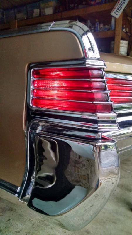

Thanks for the pics but I'd also be interested in your detailing techniques.
I had some road tar on the bumper so I sprayed WD-40 to remove that. The rest was easy because everything in the rear has been re-chromed. The chrome guy said to just use windex, but I usually polish it with a Mother's product first.

Very nice. Who did your plating ?
Metal Brite local to me out of Dayton, OH. Family business, rear bumper had a dent right where I took the picture. Also does pot metal which all the other metal around the bumper.

Pot metal stuff adds up fast, but he does it right. Strips them down and then adds copper until smooth. Those tail lights took 3 coats of copper.
