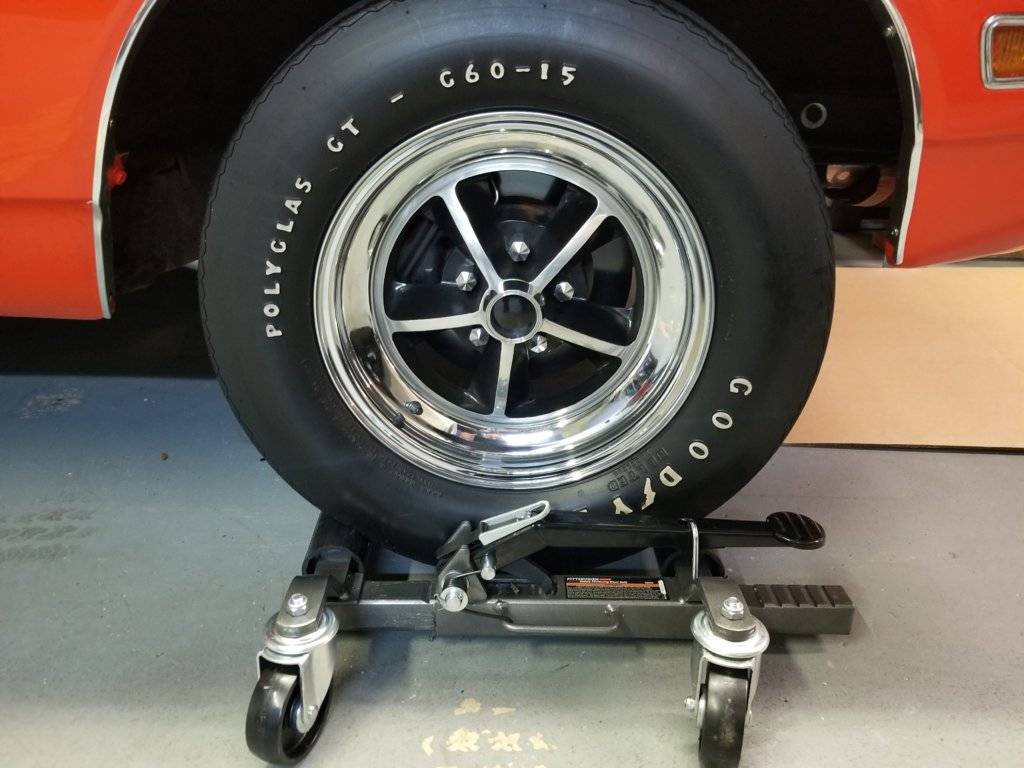

I've had a set of these casters or very similar for years. Mine are more bowed. Never had a problem with them distorting the tires. You'd be screwed in this situation without them! At least moving the car away from the wall was easy peasy!
Beautiful car BTW:thumbsup:
And we don't need no stinkin trailer queens:lol:

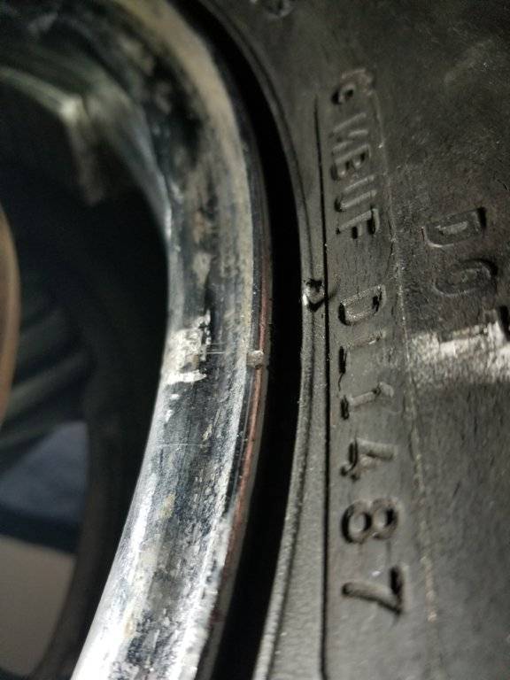

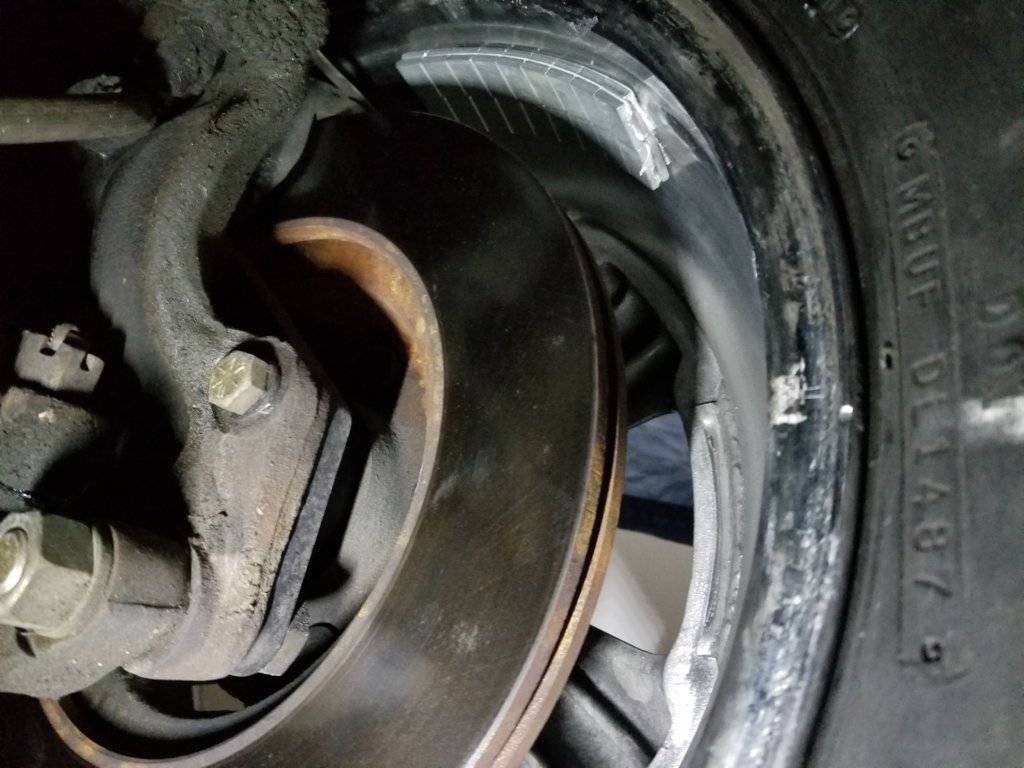

Update...got the flat fixed after trying to get in at 3 different places on New Years Eve. 3 to 4 hour waits everywhere, but the guy at Firestone let me cut in front of the line since I had the tire in my truck. Said it should be 30 minutes.
I was there for a little over an hour waiting for them to balance it and they had a hell of a time. At the end of the day, I still have 11 oz in weights on the rim to get the reading correct. At this point I was asked to come in their shop for advice.
I think it may be the tire. The tech pointed out the code on the tire indicated it was popped in '87 by showing me the last numbers on the inside wall. I'm not sure if that code is the actual repop date, but if that tire is 30 years old, so are the rest of them, and definitely time to be replaced.

I'm posting the pic with the code and the "new" weights.
Also had time to p/u the addition 2 dolly's and the car rolls a lot easier on these.
The dollys I got have a smooth curve the tire contacts, rather than just two main pressure points.

The date coding was changed in 2000. More likely that is a 1997 tire. Still old and needs to be replaced, and I'm a little surprised the tire shop didn't refuse to work on it.
https://www.tirerack.com/tires/tiretech/techpage.jsp?techid=11
I've said many times before to NEVER drive on tires that are more than 8 years old. The DOT says the same thing with all the research they have conducted on tire safety. In the desert, that time frame for tires is even less. A number of years ago, I had a left/rear tire that wasn't more than 5 years old self destruct on my 1978 NYB on the way to Carlisle on I-83. Luckily, I got the NYB slowed down and off the road without hurting anybody else or my NYB. The problem after I stopped was the spare was 30 years old and dry rotted. I reluctantly put that spare on and limped about 12 miles to a Mr.Tire and bought a new tire so I could get to Carlisle. I will NEVER drive any car ever again with tires more than 8 years old. There are better ways to die besides having a tire failure.
All I can say is I'm glad the flat happened when it was parked instead on having a blow out when driving. The outside of the tires don't show signs of any dry rot, but I guess in reality that's just 1/2 the real picture of what I have overlooked. I'll be checking my other cars now as well.
