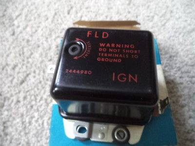

I got the slightly smaller diameter pulley (usually cad plated) on mine that was used for heavy electrical spec cars (police/taxi etc) that helped some, and then I'm going to use the adjustable voltage regulator spec'd for the same use. FWIW, my Monaco was originally equipped with this unit and the heavy duty 59 amp alternator - but over the years a standard V reg was substituted.
The great thing about that V reg is that you can bump up the idle output from the alternator with this unit. Spec'd for use with Leece Neville equipped cars AND in heavy electrical spec cars with high output standard alternators (59 amp as opposed to standard issue 37 amp).

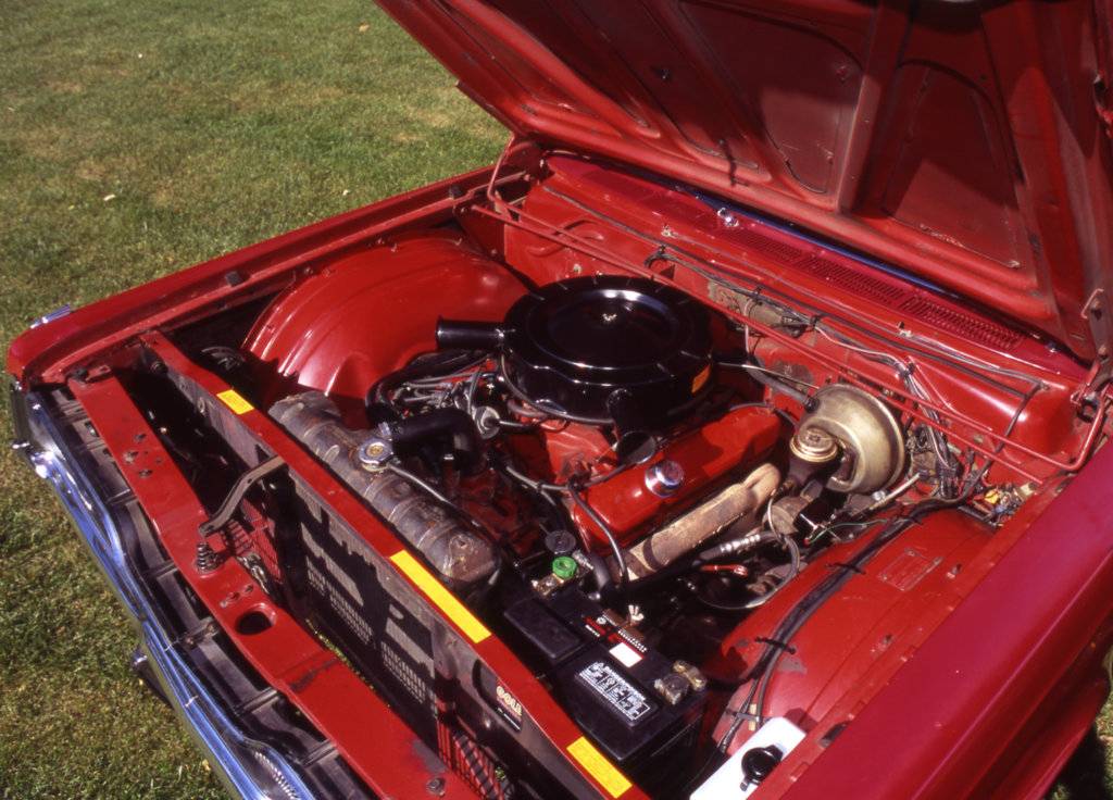

Typically mounted on the inner fender on a special bracket rather than on the firewall (see my engine bay pic). Often seen on Imperials, but seen on C bodies with lots of options...
