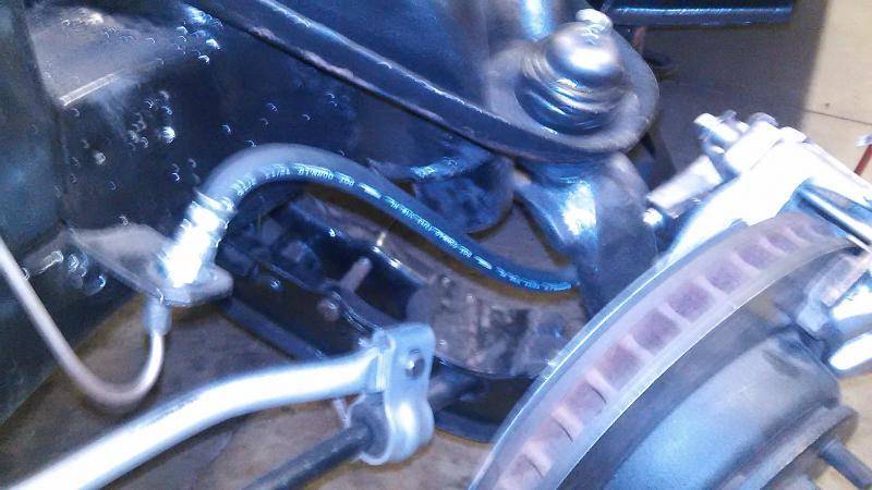

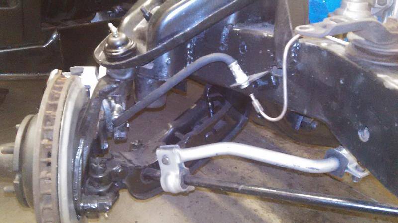

A picture is worth a thousand words! The Suspension is completely in rebound still looks a little tight! IMG_20150628_115012.jpgIMG_20150628_115101.jpg
Both are good! My guess is I'll have plenty of length once shes on her wheels. I'd still like to have two more inches! "That's what she said" LOL!
