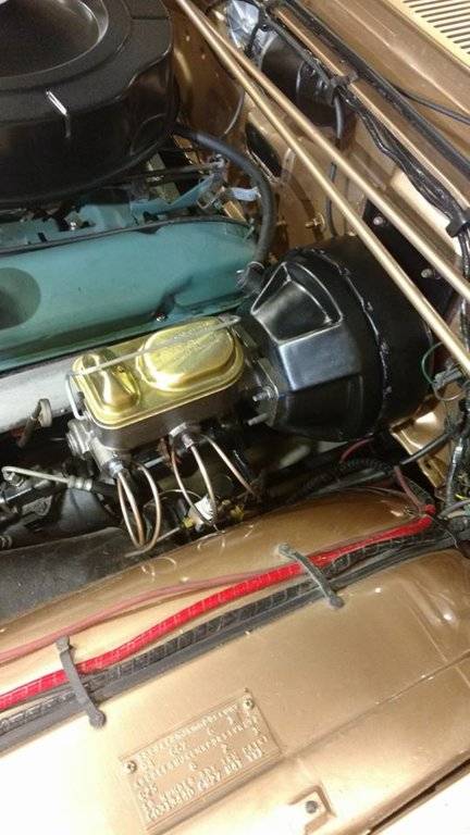

Can't comment on the "TA" set up, but I struggled with the non-factory look of the valve. I couldn't be happier with the results with the Wilwood valve. It was so easy to adjust. I nailed the adjustment in just a few minutes and it will now stop on a dime.
It doesn't jump out under the hood.
