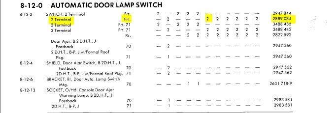

Does anyone know the correct part number for the dome light door jamb switch? Pulling the wiring off, one of the prongs came completely off the switch. Which is annoying because it actually worked prior to disassembly. I'm having a helluva time finding it in the parts catalog.
70 SF, although I'm sure the two-prong switch was used across many model lines in 70.
Thanks
They are different for the body lines. I bought the reproduction switch from VANS I think they were the same as the E. I will look when I get home if you still need an answer by then
Well, I think I found the PN. Now I just need to find one. See below:
