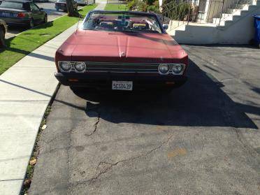

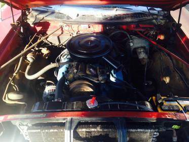

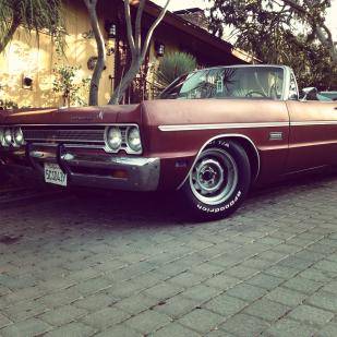

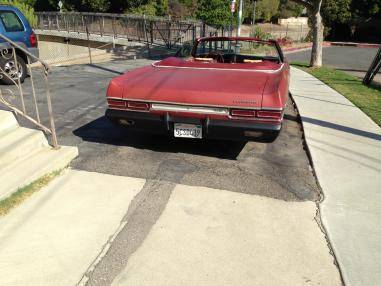

Hi I'm a new member! I just got a 1969 plymouth fury 318 3 speed convertible. The rear end howls pretty badly over 35. It's not easy finding a donor car in Los Angeles since most yards only have cars from the past 20 years. Anyways, I found a 73 ish dodge van I was hopping I could swap the pumpkin out of it into mine. In the fury iii It's a 8 3/4 "741". The van also has disk breaks I was hoping might switch with my front drums (which suck and are past due) . Thanks for any info I can get. Please let me know what cars to search for with compatible parts. I'm not trying to pay retail costs of over 2000$ for these kits new.
Welcome to the board...post some pics of your car!
