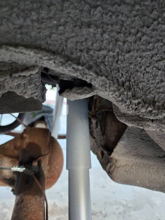

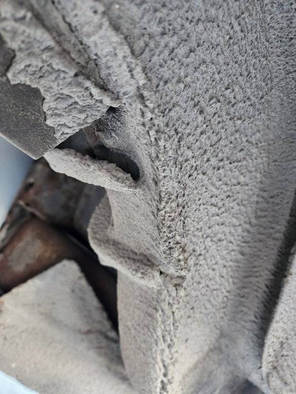

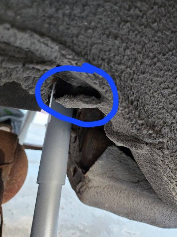

I recently had my car on jack stands for a couple months. I replaced all the front end suspension parts and replaced front and rear shocks with KYBs. When I put the car back on the ground I noticed it wasn't level in the rear. So I measured it with a tape measure and sure enough the driver side rear is about an inch lower then the passenger side rear. The front is level. While I was replacing the rear shocks I noticed the top shock mounting rail was rather easy to flex on the driver side and I noticed there was a gap from the frame. (See pic) The passenger side mount was firm and sat flush on the frame. Would this be the cause of ride height difference?
