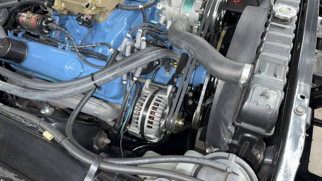

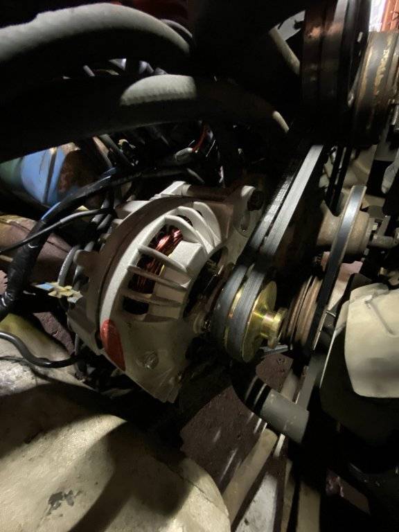

Dumb question, does it matter if the alternator ear is mounted inside or outside of the factory bracket?
Upgraded to a Powermaster, they’re supposed to be the same size, but the square back is noticeably larger.
Wouldn’t fit within the mounting bracket and block, but fits great on the outside of the bracket. All belts aligned and everything.
What matters is that the belts line up with the pulleys. That said, most all A/C dual-belt configurations had the front tab the alternator forward of the water pump bracket from around that time. early seventies big blocks.
Thanks @72RoadRunnerGTX. The belts line up and the alternator is grounded and kicking out 14.5 volts. Now I just have to figure out why it’s not getting to the battery lol.
