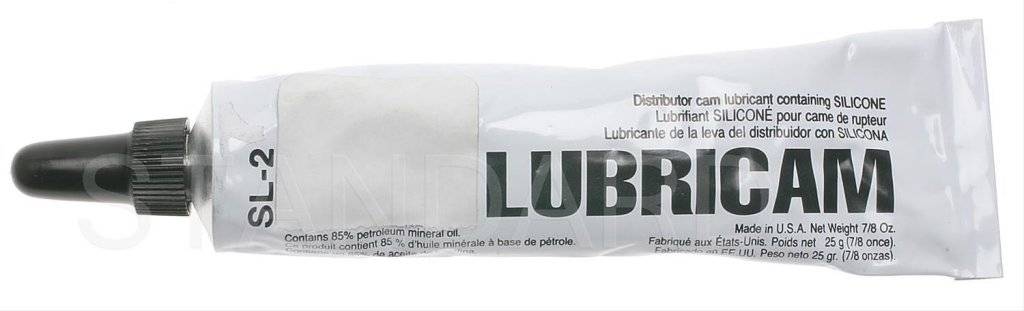

Be SURE to use the correct "point grease" to put on the rubbing block of the points!!! Many people in these modern times might not have any knowledge of such, especially since many brands deleted that little vial of grease from their point sets back in the 1980s. Mallory used to sell it in a larger tube, as did ACDelco. Specifically designed for point ignition point sets. Keeps the rubbing block from wearing down too soon and also keeps the breaker cam lobes from wearing too soon. Not greasing that rubbing block resulted from many electronic ignition kits getting sold in the 1980s, I suspect, as many related that the points in their older cars only lasted 8k miles, whereas we used to get 15k+ miles out of them in the 1970s and similar.
Just some thoughts,
CBODY67
here you go Standard Motor Products SL-2 Standard Motor Lubricam | Summit Racing

For lube you can also use pure silicone grease. I have some of the small packets that come with points if you need should go in a envelope if needed. $.55
