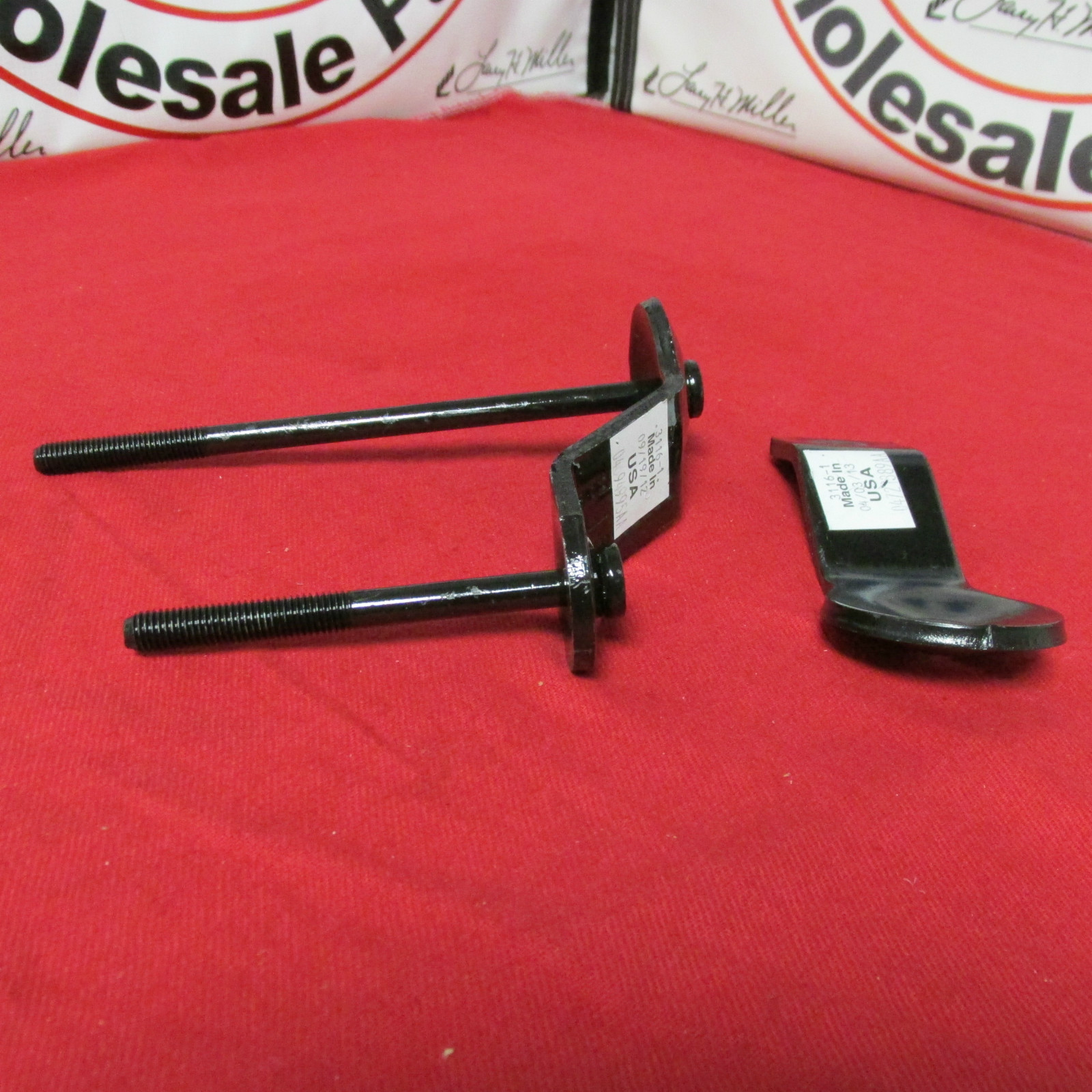

Were they the crazy bent shackles that the fuselages use?
Well YEAH John. Fer all I know Mother might still be usin' them funny bent thingz. Have you looked under any of the new rear drive stuff? I'm so lost in the '60s I don't have ah clue what Mother iz doin' with her RWD stuff today. We might all be surprised. It sure knocked me out when I saw 30 year old shacklez being hung on new for then 1990 Mini Vanz
to paraphrase Stan, sonofabitch:
None of those will work. The shackle is wider at the top and narrow at the bottom, not just bent like those.
Thanks, That's why I am here To Learn!
Is there reasoning behind the Wide/Narrow configuration?
Nope, close but no cigar. The one side should be straight.
Thread the longer pin farther down and use a straight shackle on the and you might be able to use it.
The other issue is the pin is a larger diameter and the opposite side shackle bottoms out against it.
So... I would knock the longer bolt out and replace it with a grade 8 bolt that's the proper length. Then I would find some tubing with an ID that would slip over the bolt and an OD that would match the original pin. I'd use the tubing on the short side too. Then I would use the straight side of the shackle, assuming it's the same center to center distance.
I think you can work with it....
The section of the frame that the shackle passes through is wider than the leaf spring. Why they did it like that is beyond me.
Would it be possible to combine the offset shackle set with a standard set to come up with the correct fitment?
