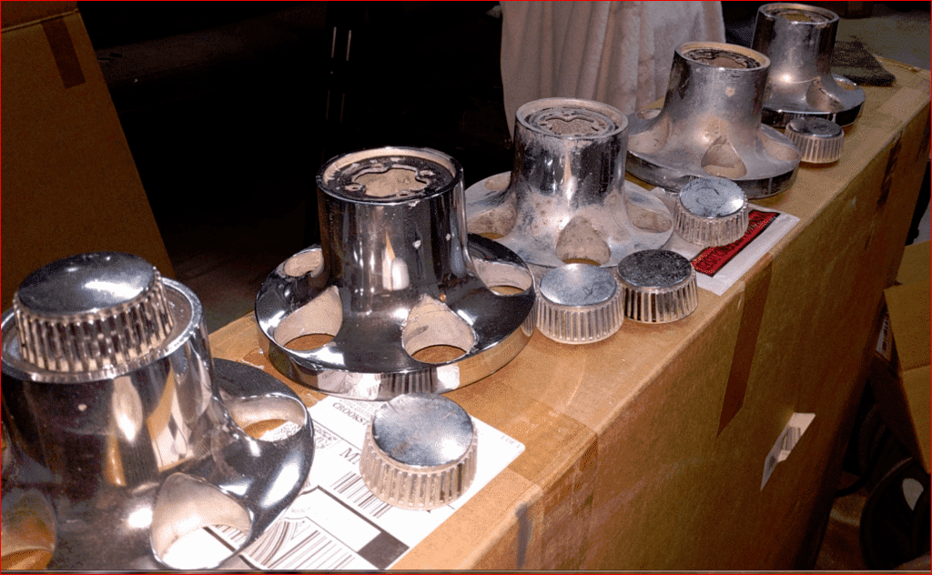

Got some shtuff I'm trying to clean up and while a putty knife and steel wool works it's real slow and labor intensive. Looking for something to make it a bit easier. It's chrome plated pot metal if that makes a difference, and there's some pits in the chrome so if whatever it is will get under plating and lift it that may not be best for me. Any easy peasy cleaners out there for us lazy folks? Not just a little overspray, some looks like it was brushed on while more is sprayed, and the whole surface is pretty well coated although it was obviously quite a few years ago.

I'm ashamed of myself for not thinking of lacquer thinner, works pretty darn good. This is what I'm working on........ the first two are just a bit of steel wool, not showing what came of the thinner on those back three although I've only hit one with the thinner so far.
